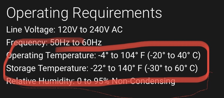

This looks doable. I’d be mostly concerned about the welfare of the NOCO itself. It’s a commercial grade product and you’ll be submitting it to some wide temperature swings. Freezing cold overnight and hot engine operating temps while driving. The electronics and plastics will age faster. Mount it and dress the wires carefully and with vigilance it should be OK.
I agree, it will likely be put to the test outside of its comfort zone during the winter months but for most of the winter, temperatures are within the recommended operating temps shown. We just have a few weeks each winter of those extreme cold temps and if I plan correctly, my battery should be fully charged and in a heates battery warming blanket during those times, eliminating the need to use the NOCO.
Worst case, if I have replace the NOCO plug every 3 or 4 winters for $25, I won't be heartbroken.
