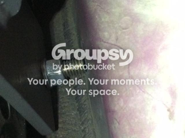

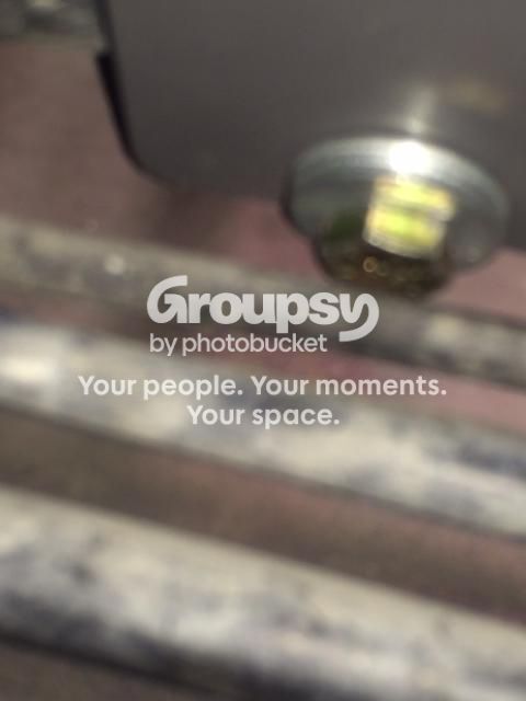

Just re-checked and found the front bolt is possibly too long.
Since it is near impossible to push the bolt through the slider because of the body, it went through from door side, inward, where others are from center-to-door.
I'm guessing when the truck turns left, the body is moving and the bolt is rubbing the body because when in the garage, still and flat, it's already touching.
I have two options 1) put more washers to space it back out, or 2)find a shorter bolt?
Think this may be the cause?
Do you see any noticeable scratches or marks from the bold on the body? If it is bumping and rubbing enough to make a vibration, there ought to be some good marks I would think.
I backed out the bolt about 1/2"…yes, it was that tight…and it solved the problem.
Glad you were able to find the issue! If you backed the bolt out that far, I'd caution you to check the torque to make sure it's in spec. Last thing you want is it coming loose and having the slider flex up into the truck body when you're on the trail.
