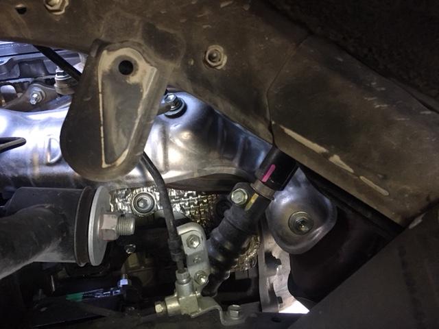

I have I rubbing noise coming from front dash window area. Only does it when running 25+. I push down on dash, out on window, and twirl a finger around my ear??! Nothing changes. Any ides what it could be?

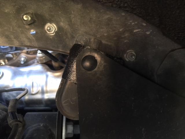

I Had the same issue, this is what I found after Months of searching for it. As you can see it was rubbing in the shiny areas. I also thought it was coming from the dash area. This is the driver side front area.

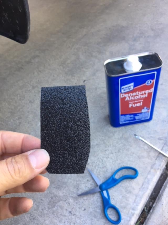

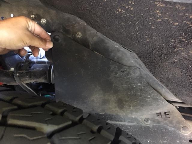

This is how i fixed it, I removed all the fasteners and put this foam around it so i don't have to hear it anymore. Hope this helps in your search.
