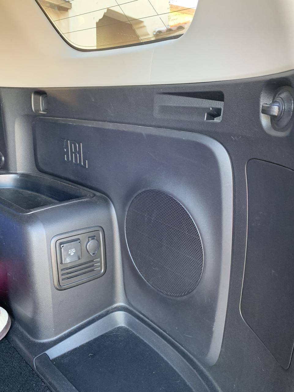

Everything I have seen is for a third row seating version. Mine is only two row and has the trim panel with a big pocket in it. It would be great to know if the JBL trim panel for a 2-row TEP is a direct replacement for my current one so I can avoid I a finished product that looks like this:
Yeah I have a 2-row also, and ran into the same issue. The trim panel for a 2-row with JBL is harder to find used it seems, and I don't want to spend that much on what is basically a plastic cover for the pocket lol. Not sure what I'm going to make for it yet though. I'm a sheetmetal fabricator, so if it won't look cheesy maybe I'll make some new, shallower pockets or a cover out of aluminum and anodize it black or something. I'll have to see how it all looks once the pocket is removed and the sub is in.
After looking at your pic again, the Al would just look out of place I think.
