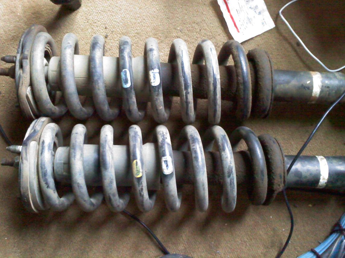

So I got my Tundra set up yesterday. Unfortunately I think the seller may have lied to, or misled scrunner who tracked these down for me. They are suppose to the blue/yellow and yellow/yellow TRD coils. Instead theyre white/blue and white/yellow with oem tokico shocks.
But based on localmotions experience with these and the thread on ultimate yota Im still gonna give them a try. They should still ride really nice and give me another .5", or at least sit the same height as my PP and KYB set up. My main concern is the ride quality though.
