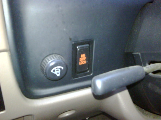

ok good, i dont remember anything by the shifter but ill find out tomm, where would the buttton be for the locking diff? thanks for the help
It will be a button with orange lettering that looks like this, on the left side of the dash.
Says:
RR
Diff
Lock
If this switch is not there, there is no rear diff lock.

ezekiel, Just so you know, your truck doesn't have a center locker.
You are either in 2WD, 4WD or neutral. You can only lock your rear differential in 4Lo unless you mod the wire harness (search for blue-wire mod) and then you can lock it in any mode.
Full time 4WD with a locked rear is plenty capable.
