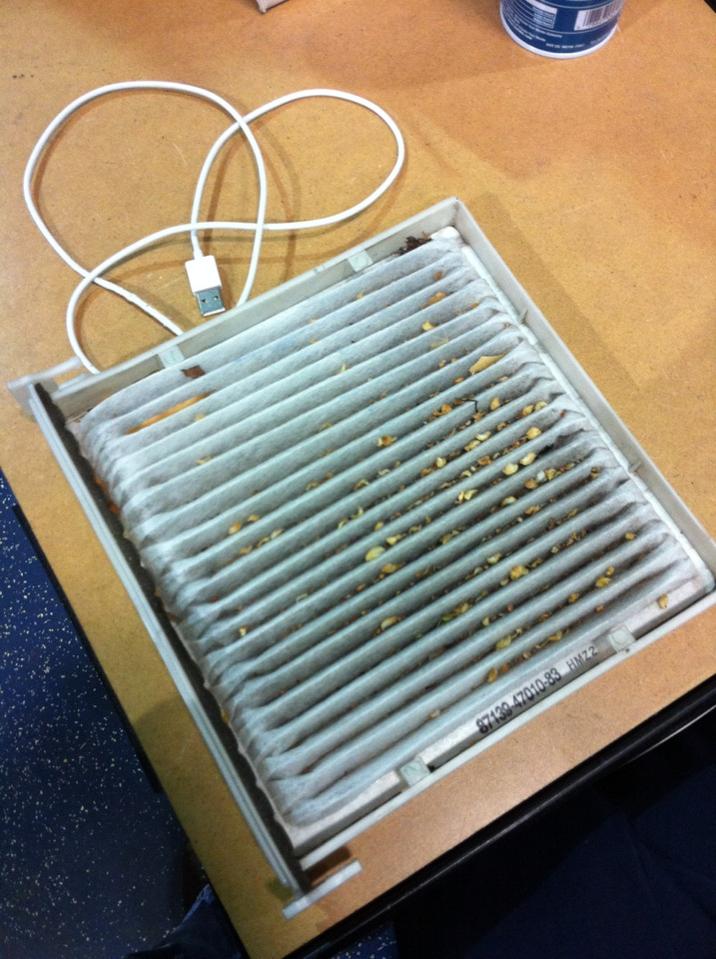

Cabin filter is behind the glove box. You have to disconnect the little arm on the right side of the glove box(one screw). Squeeze in the sides of the glove box and it will drop down. You will see a long thin door, it's behind that.
Oh, and you can get a cabin filter from O'reillys for 7.99.

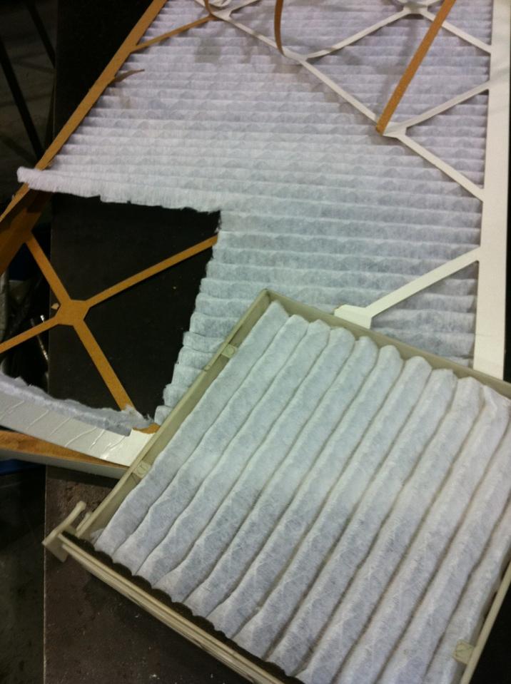

I found it. Opened my mouth before I opened my web browser lol. I pulled mine out a few minutes ago while I was here at work. Pretty dirty looks like it might be the factory filter Im not sure. Anyway I used it as a template and cut out a pleated 1 inch filter here at work. Looks great and it was free. Great info I've never heard of a car having a cabin filter.

That's a factory filter from the looks of it, and honestly? Its dirty but I see so much worse at work... Blacker than tar and full of god knows what!
A lot of modern cars have cabin air filters, but often people never change them or in some cases they were never installed when sold.
