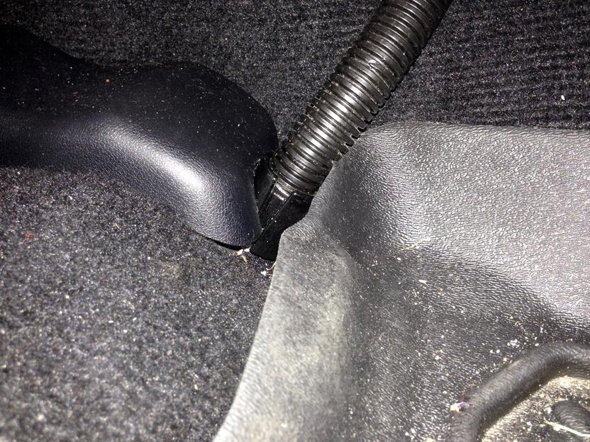

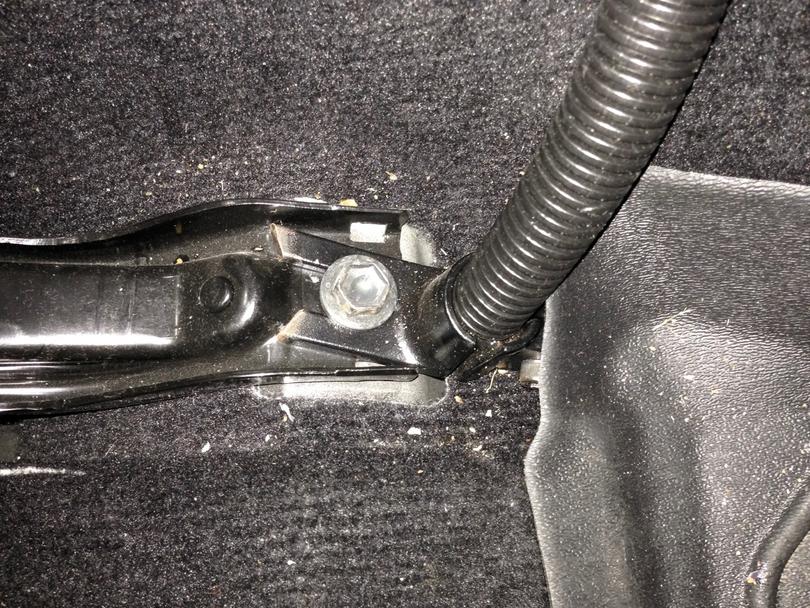

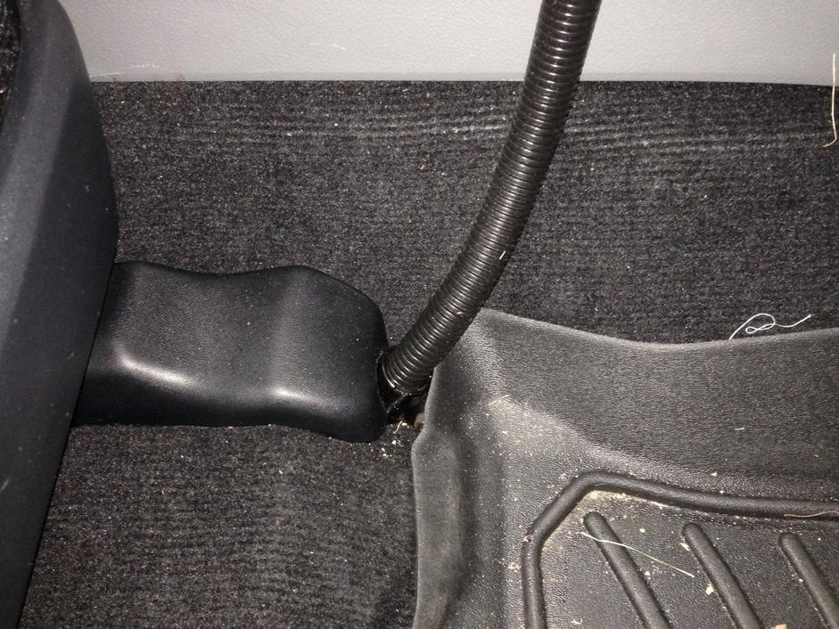

From what I remember, plastic piece is held on by a small prong on each side of it. pushing down the plastic allows the prongs to hook onto the rail. Just carefully pull the sides out and up and you should be able to remove it.
I wonder if you can install the RAM pod and then notch the bottom of that plastic piece so you can reinstall it.
That thought did cross my mind and I believe you can. I opted not too just to save that piece and you don't really see the seat mount once you have the seat back in forward position.
Thanks. I got it off. I think I may notch it. I may buy a spare of that part in case I want to revert it back to stock.
I'm going to probably reverse the direction that you did and just bend the bracket.
Thanks man.
Thanks man.

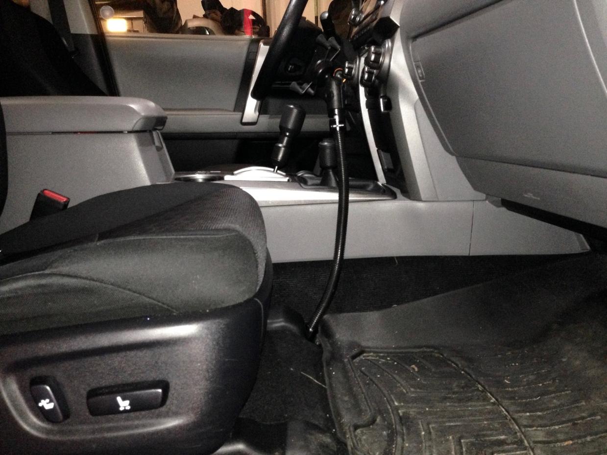

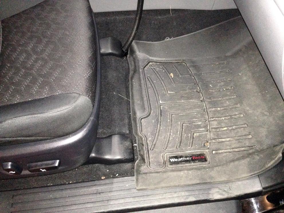

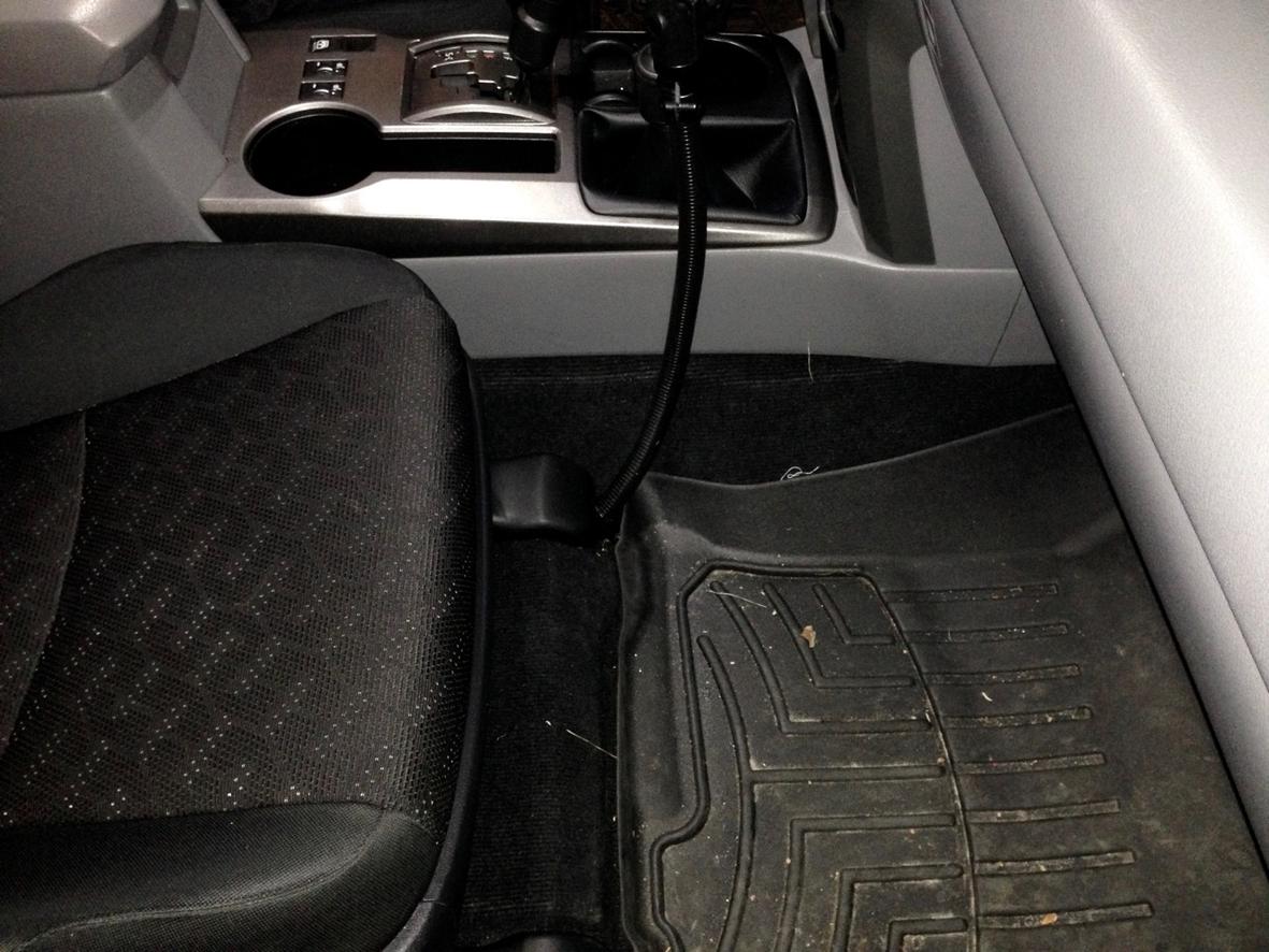

I cut the Ram Mount foot bracket pretty short and notched the beauty cover to fit around it. It pushes the Weathertech mat forward about an inch. The foot is solidly installed but there is still a significant amount of vibration at the top of the pole. It's annoying when I use it for my iPhone and pretty pronounced with an iPad Air in it. I've tightened up the bottom bolt a number of times and it isn't making much of a difference. I find that the pole also cuts into the passenger space. I don't like sitting on that side of the truck because it's right where my knee rests. At this point I think I'm going to pull this one out and put a mount on the side of the centre console like I've seen on here. That should be enough to hold the phone which is all I really use anyway.
