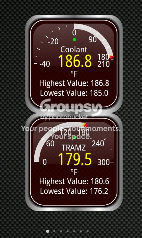

I've read 140F to 200F is the normal range.
I do a lot of highway driving in 95+ degree temperatures.
Do I need a trans cooler?
screenshot.jpg~original

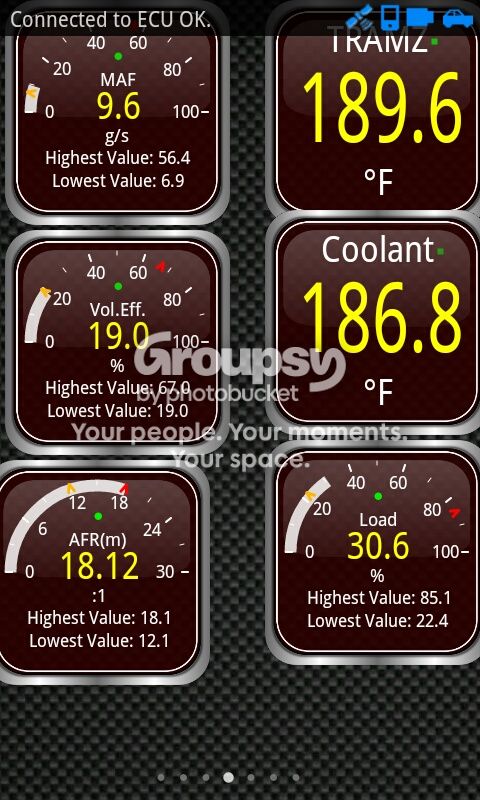

Im just curious how you got Torque to display tranny temp. I can not get method 1 or method 2 to display information and method 3 just duplicates the coolant temp. I also have the torque scan add on app and ran a PID scan with no luck.
Yea. That isn't a high temp reading. I have a v8, with the aux cooler, and when it is 99 degrees where I live I get similar temps.
220, higher, then you start to worry. But you won't see that unless your towing a lot, up a huge hill, for a good bit.
It really, really, really, really, sounds like your just looking to blow money on something. Doesn't need to be this. :)
The trans Temp is far more externally linked and the designers knew that. It is going to be a much more flexible system temp wise.
Did another up and down mountain run last night, driving the wife to a company retreat through the TN/NC mountains.
Only difference was this time we had had to do it at night due to logistics. It was 60-58 degrees the whole time and my trans temp never got about 158 degrees.
