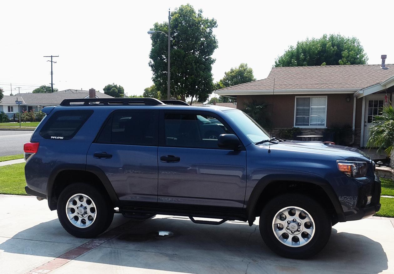

I added Bilstein 5100s with the front set to 0.85. It helped the nose dive a lot but there is still some. If you go to the 1.75 setting the 4Runner will be level and a bit stiffer. But you may get tail sag with a load. Before the Bilsteins the rear was 2 inches higher than the front. After it's 1 inch. I also added 5100s to the rear and Air Lift bags. The rear Bilsteins stiffened the ride but help a lot off-road.
