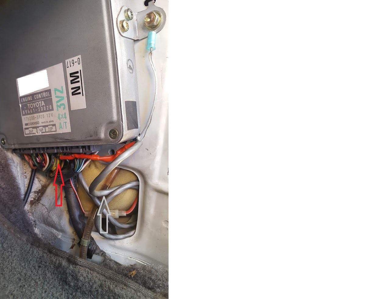

After digging into it further this weekend, someone has run a shielded cable from the ECM to the intake, I suspect this is for the knock sensor circuit - just haven't confirmed it yet.
I thought you had to pull the intake to get to the knock sensor to replace the knock sensor cable, is that not the case? I'm definitely on-board with trying that first but sounds like I may have more issues to sort our with the non-factory wiring that has been done

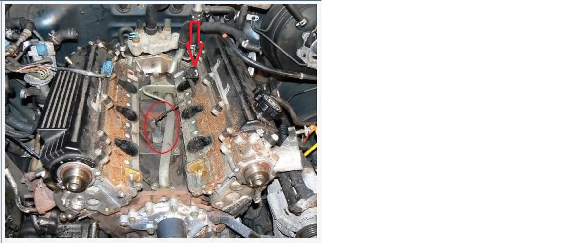

I added two pics; you can see the cable (grey arrow) was spliced into the ECM wiring harness (red arrow) and the shield was grounded. The 2nd pic shows the cable spiced under the hood right at the driver's side valve cover.

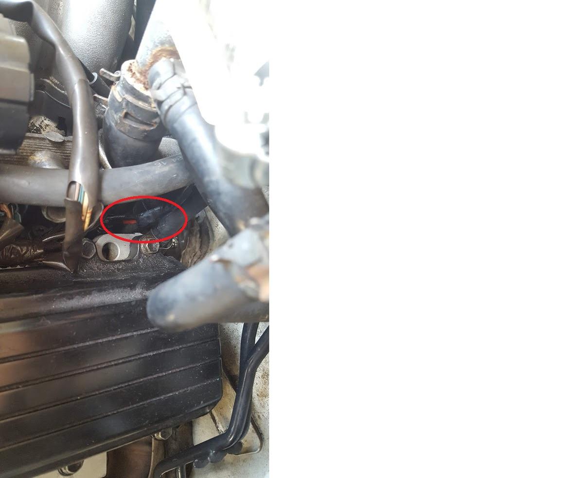

In all my research, I thought the cable that typically had problems was the coax jumper from the knock sensor to the connector where I'm seeing the splice at the valve cover. Am I misunderstanding the issue?

This is a pic from the knock sensor location thread. It was my understanding that the cable I added a red arrow to is the one that goes bad.
