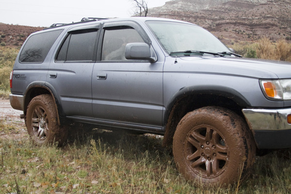

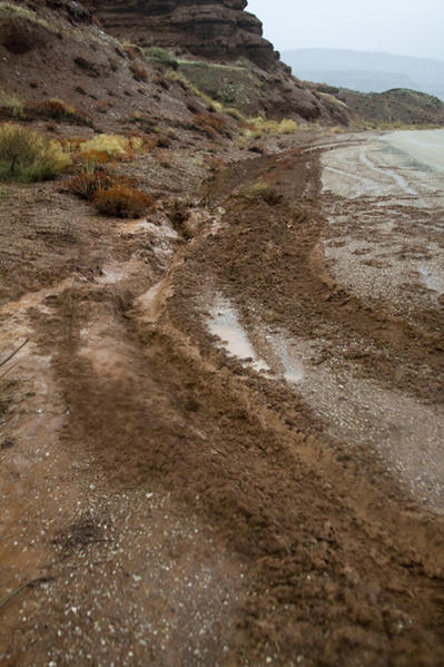

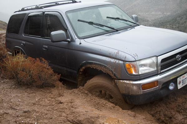

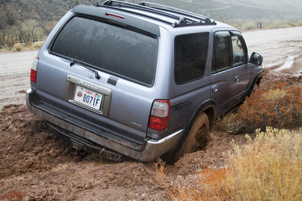

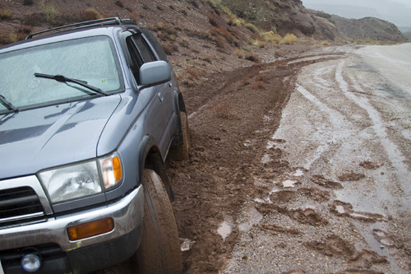

Lately I've seen some treads about the ABS systems on our 4runners, though I've only had my runner for almost a year I have had it through 2 Utah winters and have had no problems. It wasn't until yesterday when I was pulling off the side of the road and hit some really heavy mud the ABS really screwed me over. Now I know my tires aren't the best but I was only going about 5-7 mphs and when I hit the breaks all that happened was the ABS pulsing and NO stopping. I slid for about 4-5 feet until the ditch stopped me. And the pictures tell the rest, at least it was a Tundra that pulled me out. Never the less I will not be disabling my ABS for now, but will be more careful, hopefully this decision doesn't come back to bite me.
