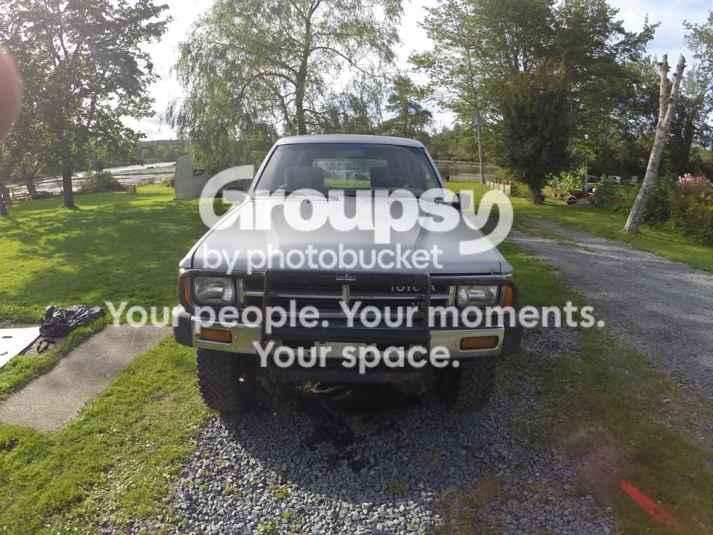

Hey there. This is my second topic on here. I have a 1988 4 runner with the 3 liter engine. Well I have spent a fortune on this machine. It had a spark issue that has been narrowed down to ecus. I have bought 5 ecus in the last 2 years trying to get this on the road. I have an extra I hope. Anyways if you reconnize this truck you might remember me. So what could be fryng my ecus? I have not driven this truck at all. It was at a crappy mechanics place stealing my money. So I have no idea what could be wrong. It does run now. Has very old gas in it right now. But it runs. And is now 1 hour and 15 minuets closer in my driveway.

I don't want to step on toes here but I think the folks at yotatech do a lot more hands on mechanical work on 1st gen 4Runners. You might also ask there. You really need to post pictures of the sliding window problem. If you posted on both forums more often you could place an ad for the parts you need. My first inclination is that you probably have a fried wire somewhere in your harness. The wires are wrapped together so it's hard to find the shredded one. You'll probably need to learn to sort the problem yourself because at $49/hour or more it would be very expensive to pay somebody to find it.
Did you or the previous owner do a lot of wiring changes? Start with aftermarket lights, stereo and alarm. The wiring short might be obvious. Worst case is you might need to buy a whole new harness. Get it from the same year, transmission and motor as yours. Same with the ECU's you buy.

So my 4 runner is a sr5 model. I guess its a body package. Anything else that comes with this package? Im not worried about the window anymore. its up now and winter will soon be here. Only time I think I would put it down is to put My Tecate 3 wheeler in the back. Yeah Im one of those crazies. 2 Stroke raceing 3 wheeler. How crazire can you get. I also have a problem finding the little cables for my emergency brake. I have a set off an older modle that I dont think I can make work."But my red neck mind says yes" Does anyone know of a common spot on the wireing harness thats prone to chafeing or breaking? Also a nice 2-4 inch body lift would look sweet.

Actually I removed the original doors with power windows. Trying to get a mvi for it. SO now people are telling me that it might be my wireing harness. anyone have a good way to check this or areas to check first?
