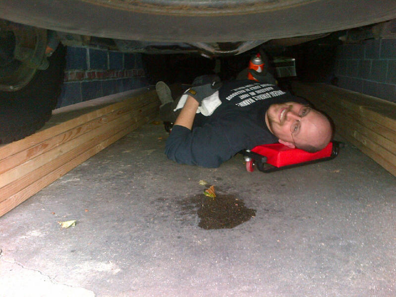

I didn't use jack stands. Instead I built ramps out of 2x10x10s, 5 per side, bolted together with some honkin hex screws. I know I can't take the wheels off with that setup, but it gives plenty of clearance for working underneath and is safer. I think for anything that needs the wheels to come off I'll be going to a pro.
For rust, aerokroil worked amazingly well. That and a breaker bar.
Thanks for the tips!
...I didn't use jack stands. Instead I built ramps out of 2x10x10s, 5 per side, bolted together with some honkin hex screws... For rust, aerokroil worked amazingly well. That and a breaker bar.
Here are my ramps, with me underneath spraying some aerokroil the day before.
