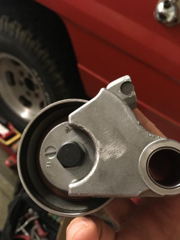

Now with noise! Any idea what would cause this? (timing tensioner pulley)
SigSaucer
New, supposedly OEM part from the Amazon kit that a lot of people recommend here. Has 12,680 miles on it.
Any ideas?

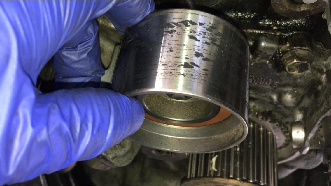

It's obvious some rubber from the belt transferred to the pulley like the belt wasn't rolling smoothly on the pulley and it sometimes dragged across rather than rolled across. Does the pulley bearing feel ok?
It looks like your engine is kind of oily. Any sign of oil contamination on the backside of the belt? I could see that causing gunk to accumulate.

The pulley bearing is loose from side to side. Here's a video: YouTube - you can see the play towards the middle/end of the clip . The thing is, I ordered a new genuine tensioner pulley from a Toyota dealer, and it also has play - although not as much as the bearing in the photo. How much play is acceptable in a new bearing? The top idler (between the camshaft sprockets) has zero play in my fingers, for example. It was also completely clean aside from one small speck of rubber.
It does look like that, but that fresh wet area was actually caused by a leaking hood scoop. It rained and dripped onto the block after I tore into the engine. No gunk or contamination anywhere near vital parts. The belt looks good as new but as Tim said it's obviously been transferring some rubber onto the pulley.

Maybe the rubber transfer is from the belt shimmying on the pulley from the bearing movement. But, why would the belt move a bunch unless something is instigating the belt to move in and out? I've experienced one 3.4 liter engine that had gross in and out crankshaft play due to the thrust washers giving way. If the crankshaft was able to move in and out, that would also drag the timing belt with it in and out causing the dragging on the lower idler pulley.

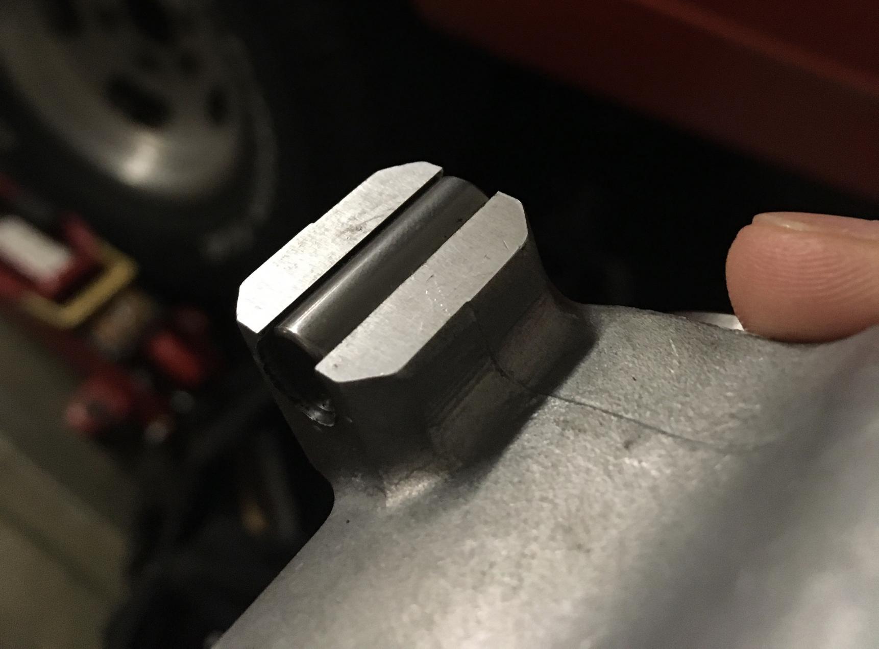

Here are two more photos. Not sure if that mark was on the back of the pulley when I originally installed it.

Uh oh. I think one of your thrust washers may be on it's way out. That play is not normal. That little bit of movement in the crankshaft is causing the belt to move a tiny bit in and out causing the belt to rub on the pulley.
