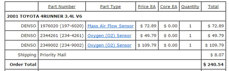

Just ordered mine from Rock Auto
[MENTION=133274]Birdie[/MENTION] Just ordered mine from Rock Auto. Dirt cheap. It was time to replace these sensors soon anyway. Was throwing a 0420 code intermittently the past six months. (probably from my 15 year old exhaust system and not the sensors...but can't go wrong) Getting ready for winter maintenance, headers, cat, new muffler...
EDIT: You probably only need the upstream A/F sensor: 234-9002
I used the same parts. P0420 went away, and has only popped back up one time, and that was before I changed the plugs that had 210k miles on them.
