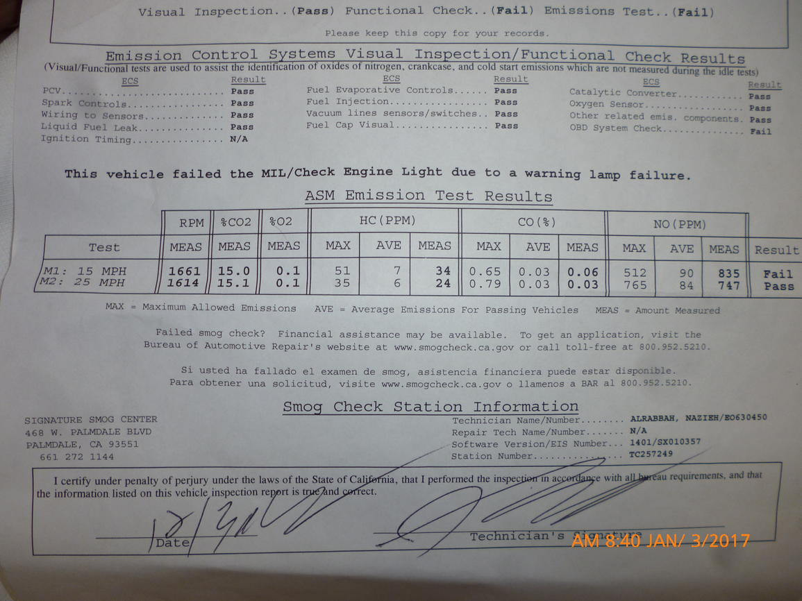

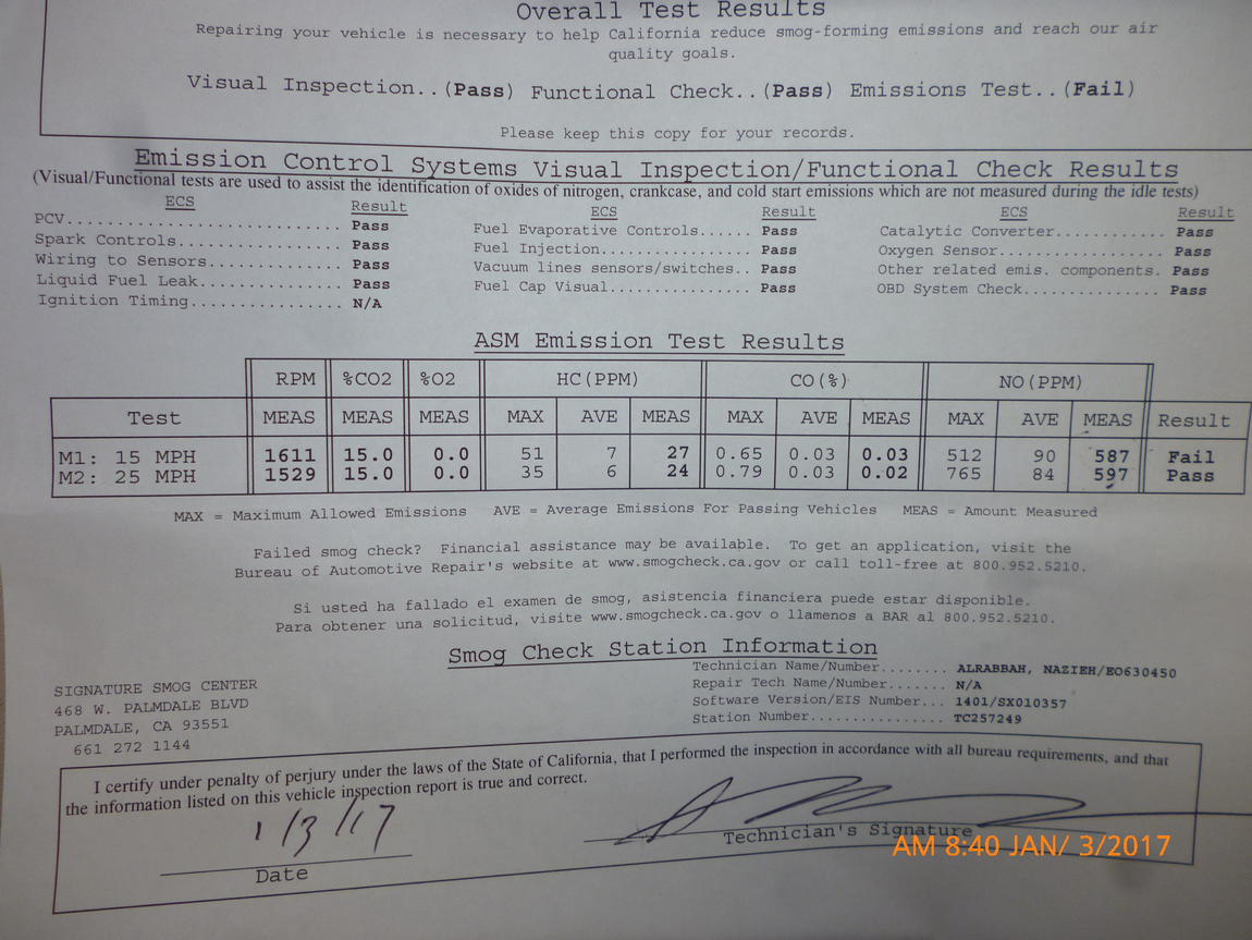

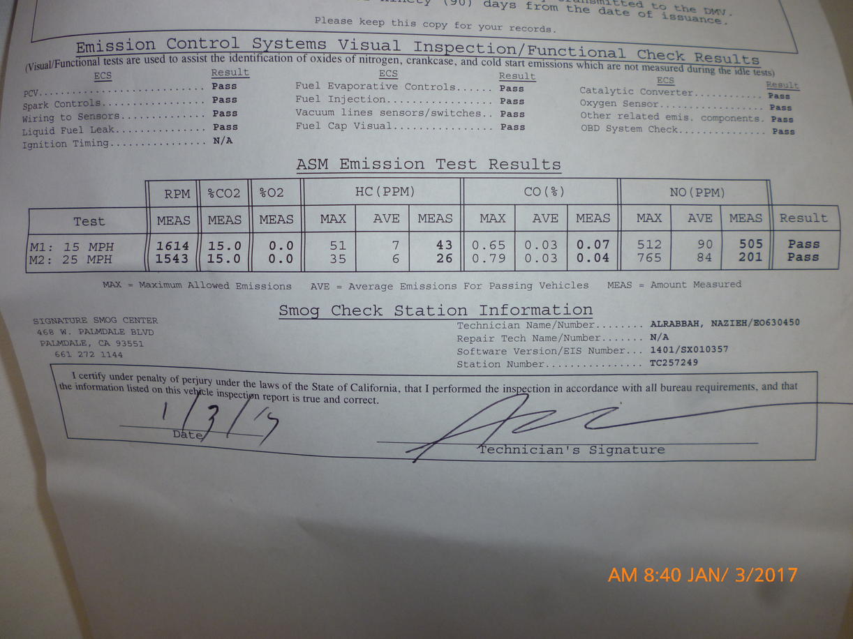

Failed smog check twice for high NOx at 15mph
First I want to thank all you Toyota and 4Runner owners out there, you rock. I feel obligated to give back to this forum because you guys out there have been very helpful in guiding my through this last smog check. I own a 1997 Toy 4runner 4x4 3.4 limited with 372,000mi. Before the smog check I changed plugs, changed oil(I run Mobil 1 10W-40 high mileage) and filter, and new air filter. This was my first smog check::wtf: P1060819.jpg
I failed the 15mph with NOx =835ppm. The guy at the smog shop suggested I check for vacuum leaks. After this happened I had to re-group. I started scanning all the forums, youtube, and google. What I came up with is that they said I had high internal combustion temps and I needed to cool them down. At first I wasn’t sure what to do. I think I lost a few hours sleep thinking about this whole thing. I read article that told you to just about check and change everything. Well, the truck was running great so I didn’t think it was something major so I checked for vacuum leaks and I did find a couple of vacuum hosed that were starting to cut on the ends so I replaced them. There was also a small crack on the throttle body intake duct right where it clamps to the throttle body so I fixed that. Also the big hose that plugs into the aft side of this intake duct was starting to get a little loose over the years to I put a hose clamp on it.
The next thing I did was run Cat-A-clean through engine according to instructions. Then filled up tank with Shell premium and added 1/2 bottle of 108 octane boost. I also added 3 oz of acetone at this time. Then I took for a long drive and immediately took it in for a re-check. These were my numbers on smog check:toilet3: #2 P1060820.jpg
The NOx came down to 587, but still not enough. After talking to my smog man, we agreed I should change both O2 sensors, so I did! Then I took the truck for a warm up drive. I decided to dump the rest of the octane boost into tank. Then I took it back for another re-check the same day. These were my results: :boink:P1060821.jpg
Hooray!!! It passed, but not by much…. Whew. Thank God its over, for now…
