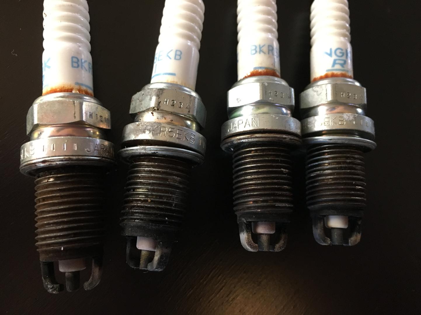

On a misfire like that (more than one cyl., not on the same coil), the first thing to do is inspect the plugs and wires involved. That can tell you a lot. I wouldn't venture a guess until that was done. Feel free to post pics of those plugs. Are you sure you got the right plugs? What were they?

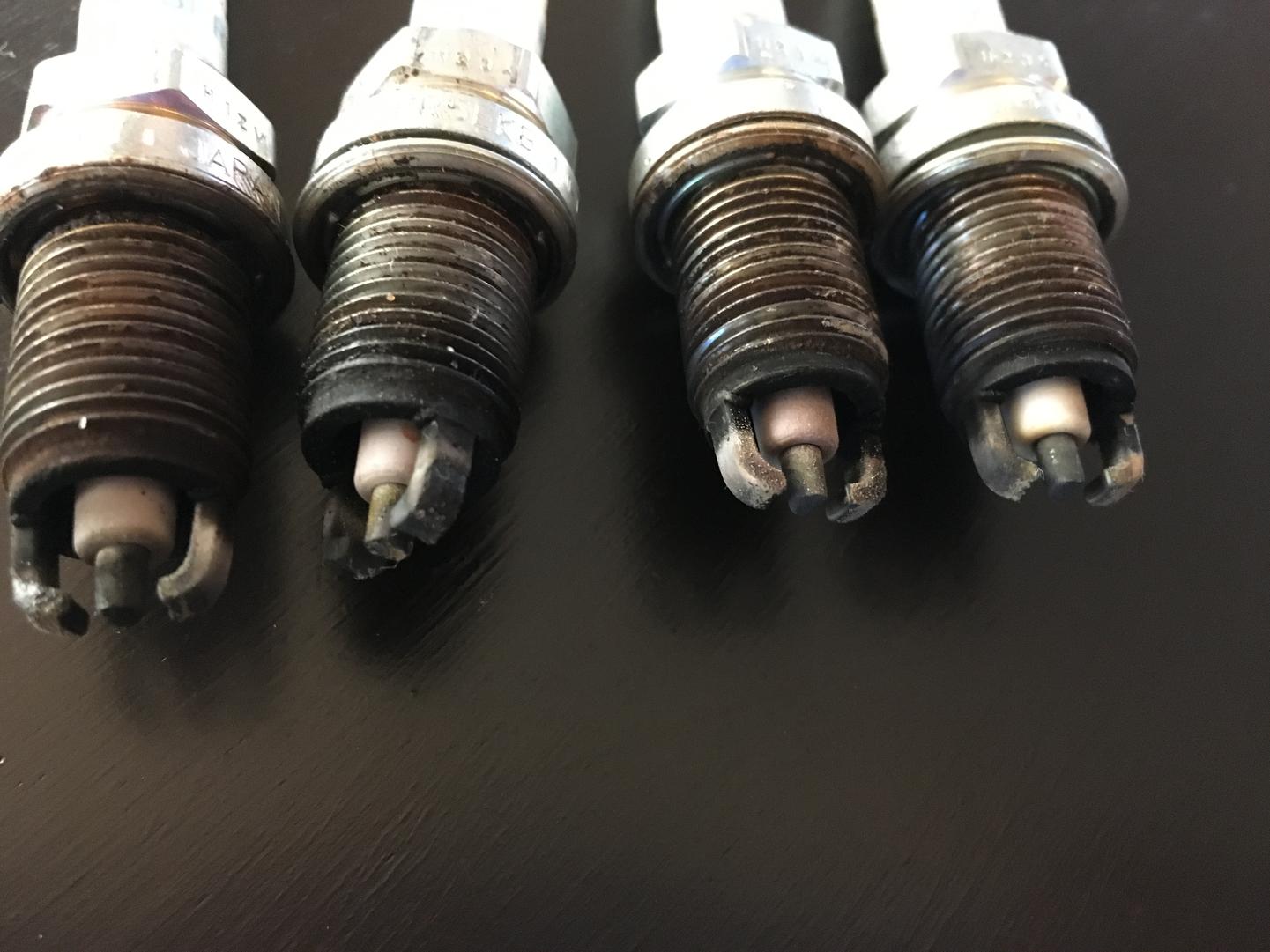

I like the way you think, TheDurk, and I appreciate your help. Here are the plugs I took out of it. They are about 3 years old with probably 20k-ish miles.

OK, no red flags there. I'd change my upstream O2 sensor unless it's recent. The downstream may throw a code but has no effect on engine operation.
