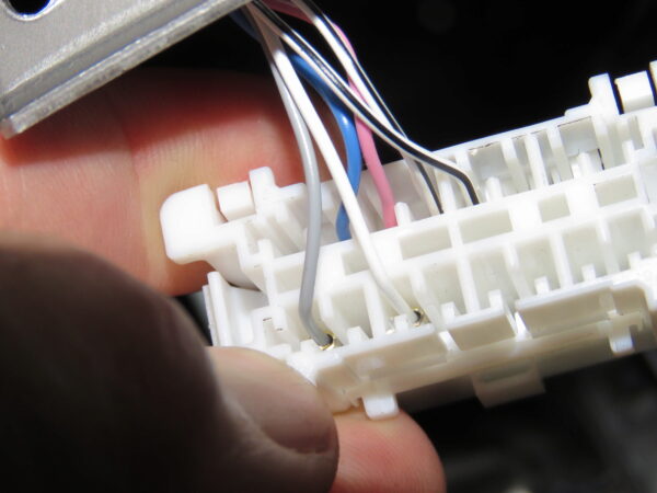

Did a lift and upgraded UCAs last week on our 2020 ORP.
In the process I tore an ABS wire (I know... I know...) which I've since replaced. The ABS flashing lights cleared, but I was left with an issue with the Pre-Collision warning system nagging me to go to the dealer.
Checked the code, and it is C1290 - Malfunction in Zero Point Calibration. This is related to the centered steering-wheel angle. I can see that being a separate issue based on my first test drive with the UCAs being set slightly differently (and steering angle was off). Again, since corrected, and alignment has been done, but code remains.
Shouldn't be a problem, right? Just do the trick with the DLC-3 (OBD) connector by jumping pins 4 and 12. But it didn't work...
Did a contortionist act, and looked very carefully at the front of the connector. Hmmm, it didn't look like the connector at position 12 was occupied. Pulled the connector off, and my suspicions were confirmed. Looks like on 2020s we get pins 4,5,6,7,14, and 16. So ground (4,5), Can Bus (6,14), K-line (7) and 12v (16). No more TS (or TC) lines.
Looks like this may require TechStream to do a ZPC. Any advice or suggestions are welcome. Anybody know if the TS line might be available someplace else? I'm having a tough time running down the 2020 schematics.

I had the same issue with pins 4 and 12 not working. I tried pins 5 and 13 and it worked. My OBD appeared to be upside down, pins 5 and 13 are 4 and 12 when flipped upside down.
The pin numbering is the same whether the plug is installed right side up, or upside down. But it does take a bit of concentration to sort out which is which while looking at it while contorting down under the dash.
Was your success with a 2020 model?
None of the vendor specified pins are populated in mine. As shown in the picture. Mine is a 2020 ORP. Perhaps other 2020 models are different. If so that would be good information to know.
Pins 4&5 are both ground.
Pin 14 is CAN-bus low. On older models, before CAN-bus for OBD-II was fully defined, Toyota used to use that as a vendor defined pin (for Ts line) - that's why it was listed as the pin to connect for older 4runners. Not sure when the change happened. But when it did, and people used the older instructions of connecting ground to pin 14, they were actually grounding the CanBus Low line, rather than the Ts Line, with unexpected results...
Pin 12 - That was the vendor defined Ts Line up until 2020 - but is not available in my 2020.
Pin 13 - That was the vendor defined Tc Line (used for other things, but not ZPC) up until 2020 - and again not available in my 2020.
