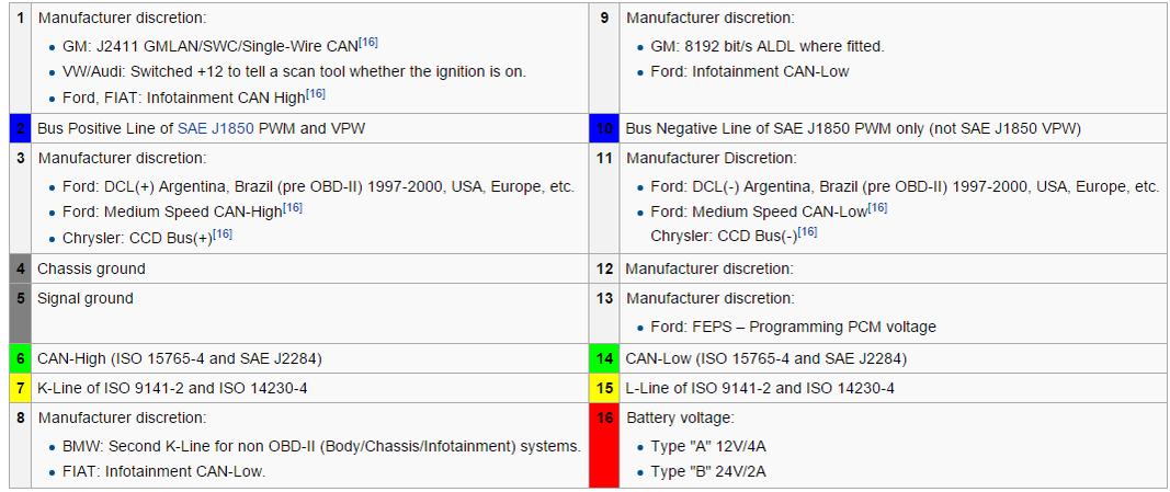

It's part of the spec for all vehicles with OBD2
Pin 16 Battery Voltage

Not sure if there are any inspections where you live, but tampering with the OBD port to change Pin 16 is a big no-no.
Pin 16 will always have battery Voltage, it's a requirement in the OBDII specification to allow scantools to communicate with the vehicle via an integrated 12v source. I don't know if you recall OBD-1 systems, but often you had to clamp onto the battery or use the cigarette lighter plug to get power for the scantool.
As for tampering with the OBDII Plug... that falls under the whole "Tampering with federal emissions devices is prohibited... blah blah blah" deal, which many people in the automotive world choose to ignore... despite it being a federal offense.

Look at it this way. That pin 16 is always hot because it's on the battery bus. The OBD II connector was not designed for accessory or other uses. It was designed as a vehicle interface for troubleshooting and programming.
