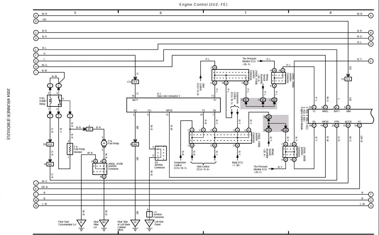

So I've been scouring the forums here and all over the web searching for answers to no avail. I've had a few issues arise (CEL and such) and wanted to scan the ECU to see what the problem is. Upon connecting the OBDII scanner to the DLC I realized there wasn't a connection between the two? The OBD reader does power on when plugged into the port and I've tested the voltage on pin 16 and it's getting 12v constant so there is power and all the fuses are good, it just reads "unable to connect to ECU."
I guess my questions would be how to troubleshoot and diagnose what's wrong with the connection between my DLC and ECU? I can't seem to find an accurate pinout diagram of the DLC anywhere for an '04 T4R 4x4 limited so I can tell which pins are which and to where the wires run to in the rig. While falling down the rabbit hole I've also read that they may be wired differently depending on when in 2004 it was manufactured, specifically pre and post August 2004??? (Mine was made in July 2004)
Also I've recently read on other automotive forums (Audi and VW) about the "After Market Radio Problem" (Ross-Tech: VCDS: Afterrmarket Radio Problem) which apparently after installing an aftermarket stereo can cause a disruption between the DLC and the ECU because of the K-line shorting to +12v? Not sure if this can be an issue for Toyotas, but I do have an aftermarket stereo with steering wheel controls that all work well.
In reference to the pictures I've (unsuccessfully) attached, looking at the front of the DLC it appears to have wires running to 4, 5, 7, 9, 13, 14, 15, 16 pin placements. Looking at the two pictures from the back (sorry for the lack of clarity), it appears to be wired: 4(White/Black) 5(Brown) 7(Red/Yellow) 9(Black/White) 13(Pink/Blue) 14(Red/Black) 15(Red/White) 16(Orange)
So in summary I just really want to know the pinout for the DLC (diagram if possible) and why the ECU won't link to the OBDII scanner and how to troubleshoot. I should also mention the ECU has already been replaced once before about 5 years ago, after the first aftermarket stereo was installed, but before installing the second aftermarket stereo.
Sorry for the long convoluted post and many thanks to anyone offering up whatever little info they may have!

Progress update
So in the past week I haven't had much time to work on the rig, but I have had time to research more which has given me more insight as to what might be going on. I was able to locate and purchase a wiring diagram and locate the schematic for the DLC3 which I have attached a picture of to this post. From viewing the diagram, I see 7 wires that run into the pins of the DLC. My DLC3 connector matches the 7 pins in the diagram, but then I have an 8th wire running to Pin 9 that I'm not sure what its for (TAC?).
Now to really where I am at the moment. I've learned that when dealing with communication protocols, '04 TR4s use ISO9141-2 to transmit information. These pins are located in positions 7 (K-line) and 15 (L-line). Pin 15(L-line) just initializes the ECU to fire up while the rest of the communication is done using pin 7(K-line). To test these lines they should have ~12V of power running to them and when they're communicating, they should briefly drop to 0V during communications. Pin 15(L-line) has 12V and drops when the scanner is connected meaning its telling the ECU to turn on. The problem I think is with pin 7(K-line). Without the scanner hooked up the voltage is basically 0V and when the scanner is hooked up it hovers around 1V which is a far cry from the 12V it should be providing. This points to grounding or short somewhere pulling the voltage away from pin 7 and not allowing communication with the ECU. I'm starting to think it must have something to do with the installation of the new stereo and there not being any communication (data link) between it and the ECU via the K-line therefore possibly grounding the signal and not letting it complete the K-line circuit. I doubt its an important module failing because its been this way for over a year now (no link between the ECU and the DLC/OBD2) and everything has worked fine as far as engine and electronics have gone.
My new questions now would be how do I pinpoint where along the K-line is the signal being grounded? Where is the K-line running into the stereo (which wire in the harness)? Has anyone ever heard of this happening before in Toyotas? I feel fairly confident that if I can figure out the grounding of the K-line I will be able to establish communication with the ECU again.
Thanks again for everyone's help and I hope we can solve this isssue soon!

It's years later, but I purchased an 03 V8 in 2026 with the same communication issue. I've tried multiple scanners, with the same problem. Those same scanners work on older 4th gens as well, which I've witnessed in person.
Now at this point in time, we have ChatGPT, Claude and all these new AI models that help troubleshoot. The issue with all of these models, is they pull old information off forums and end up putting you into a troubleshooting loop with no end point.

All fuses are good. All prongs are getting 12V on power when grounded as well. The ground fuse is good too.
Note* There are some leaks from the roof that I'm working through as well, but the driver side pillar has water come through during rain. That's a whole 'nother topic. Could possibly cause, or have caused a disruption in the wiring. I'm very hesitant to start taking all that apart before trying something else first.
There is a terminal block that is in the drivers kick that gets damaged from water ingress like you describe, that bricks the ECU on the other side of the car.. I suspect that's what is going on and your ECU is partially bricked. Be warned a replacement ECU has to be programmed at the dealer.
