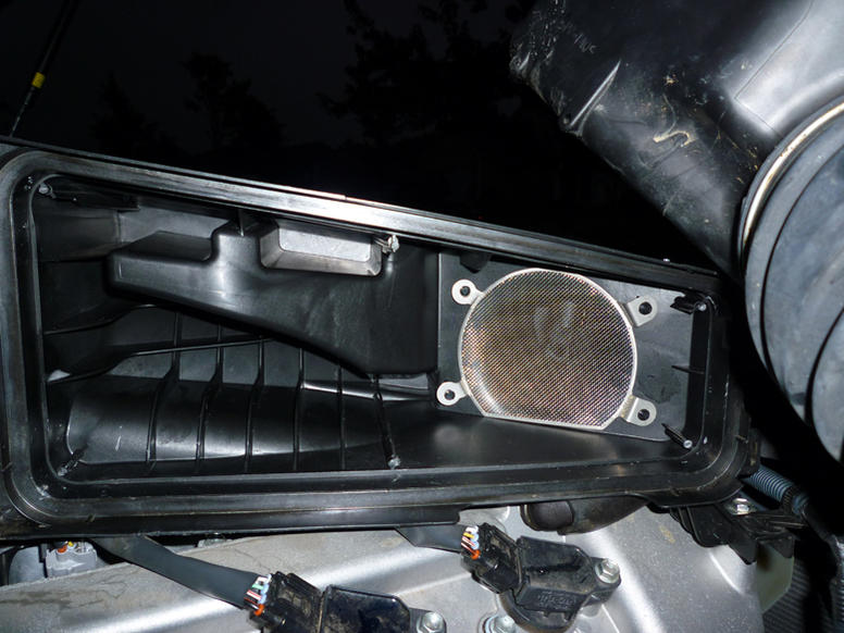

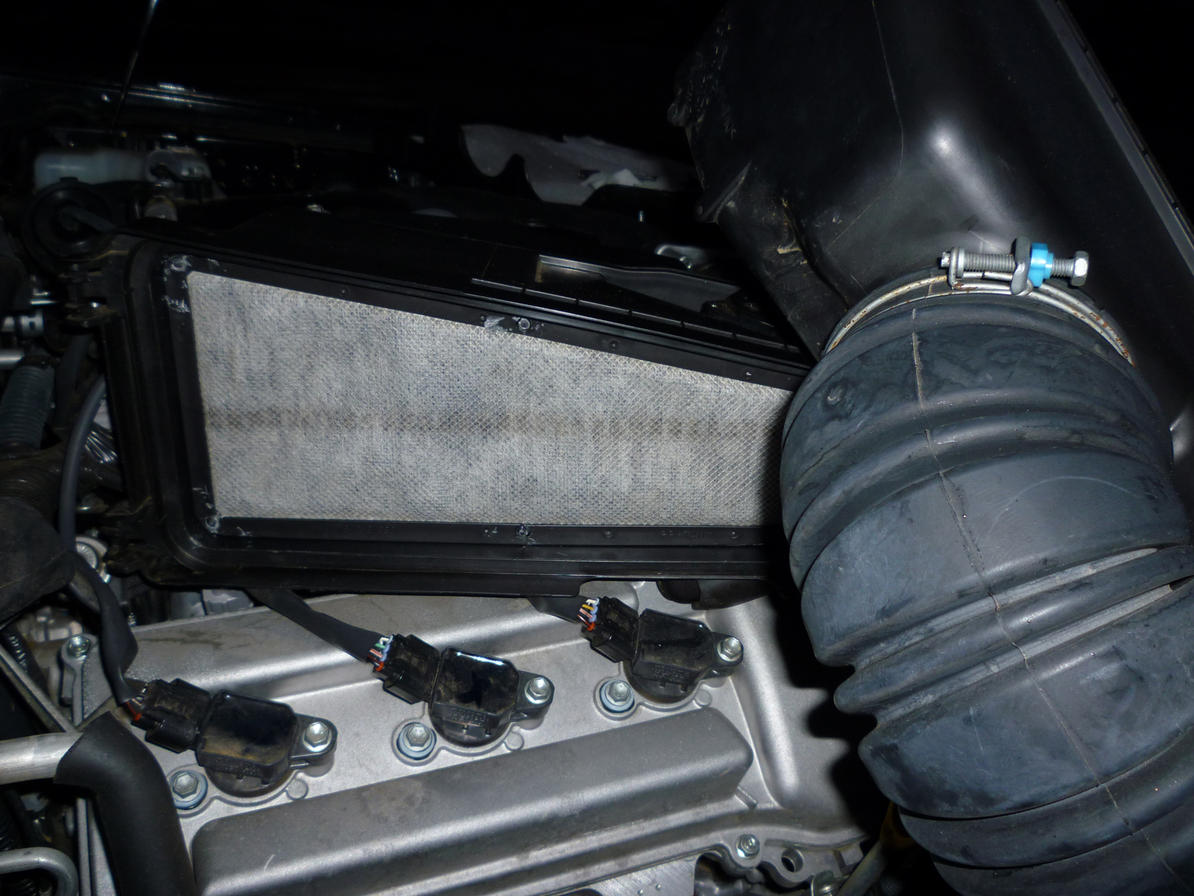

I am adding some pic's for the members and viewers with the V6 engine. This is a really easy mod if you decide to do so. I just used a flat head on the 6 rivets and it popped right off:
Before in the air box after opening it:

I am leaving the mesh on. I think it will keep anything from getting down in to the engine if it ever got through the air filter. Like chuncks of dirt,mud, sand build up,small sticks and what not. It is a good protective barrier and i go wheelin in the Carolina woods every other weekend. Stuff gets nasty out here quick aspecially if it is a little wet. An easy trail can turn in to a challenge with the varying weather we have here. I do plan on putting a TRD CAI on one day but right now everything is pretty much stock aside from the HCDelete. Yeah, i would keep the mesh on it serves it's purpose but the Hydro Carbon Filter not so much. Unless you are really concerned about a little bit of gas vapors burning up and getting in to the atmosphere but i think it is ironic that here in the south they still let people out in the country burn there trash outside.:barf: Stinky, oh yeah and i did notice now with the filter gone i do not get as much of the sulfer smell but it is still there if you get on the gass on a hill or for any other reason. Just keep that back window up or get a side exhaust system mine is still stock with the resonator coming out the back.:peace:

You have me sold on this one. How thick is the filter on the v6? I'm going to try and carefully drill mine out (drill out the plastic rivets) just in case I have to put it back in if the dealer says anything about it. I figure I can always super glue it back in place if I just drill a neat hole.
Just did mine as soon as I got home. I first pulled the 20amp EFI fuse (as per CJ3flyer, thanks!) then I drilled out the rivets carefully just so I could put the filter back in if needed (warranty/dealer issues). I used compressed air to clean off the plastic savings before pulling off the filter. Then after I pulled the filter off I cleaned the shavings inside. Closed it up, put the EFI fuse back in (left it out about 20 minutes if that).
