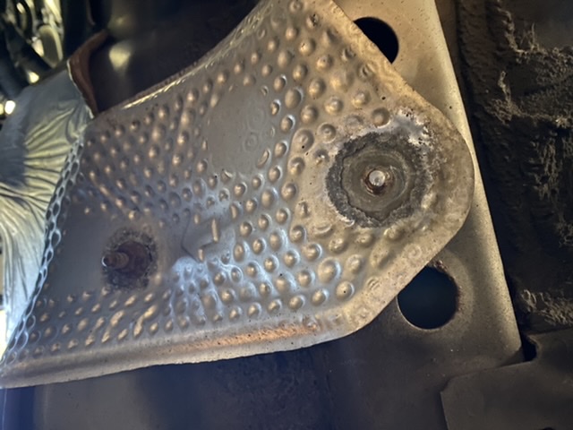

Found a loose heat shield going up toward the engine. The shield has broken loose around the bolt so I was gonna put a big washer back on it, but broke the little bolt off! Now not sure what to do?

Glad it was a minor issue. See if you can get some grips on the remaining stub, and unscrew it
Unfortunately not enough bolt left to get ahold of. Should I try drilling it out?
