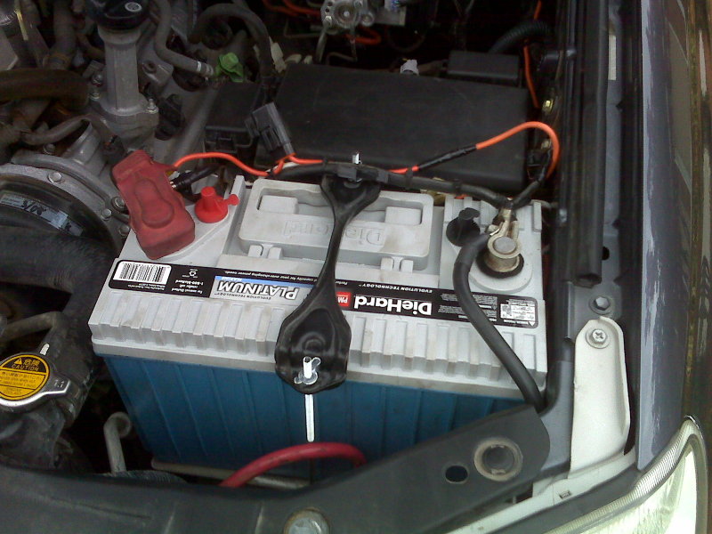

But I do like the Sears platinum batteries. I bought 6 this summer. 4 for the boat and one for Audi and her Honda SUV. My 4runner still has the Panasonic in it.

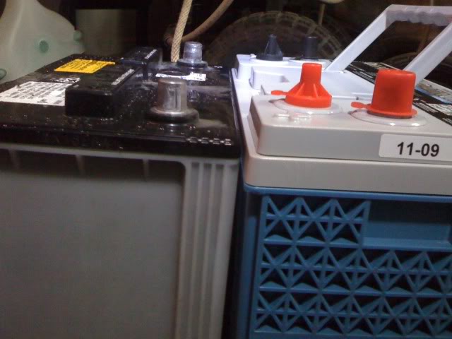

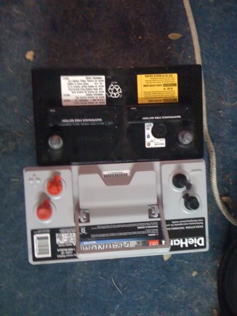

Well I went to Sears Saturday morning and picked up a P5 (group 35) Diehard Platinum. I got it home and was about to throw it in, but then I held it up next to my stock Panasonic and had second thoughts. It is significantly smaller than the Panasonic so I did a little more research.
Even thought the P5 Diehard Platinum has 740 cold cranking amps, and the Panasonic comes in it 710 CCA, the smaller P5 has almost half the reserve capacity. The reserve capacity on the DH was 100, while the Panasonic comes in at 160. Again, if this was just an around town car for me, I'd be more than happy with a smaller battery. But for offroading, camping, long road trips, etc., I'd like to have a little more battery under the hood.
gig, since you are going to sears & looking for the largest bat that will fit,as li runner recommended before, the SEARS plat. marine PM-1 is deep cycle with 205 reserve & is the largest but heavy batt. that will fit. odyssey vs diehard platinum « Batteries | Compare Reviews and Trusted Advice from Battery Experts
This is something that I'd be interested in doing. It looks like this battery will just barely fit with a few minor modifications to the mount and the length of Terminals. I might take the DH P5 back and look into something like this.

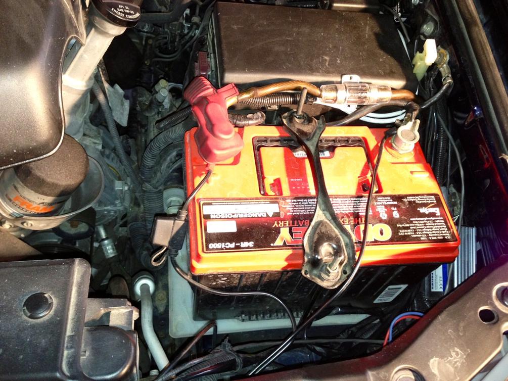

I picked up a Odyssey 34R-PC1500 fit very well no mods needed The (R) is whats needed. I looked at a few Diehards but found a deal online. Both are almost the same but they don't make the 34R-1500 in a Diehard.

Sorry to revive an old thread, but I didn't pull the trigger on a new battery until this week. My ol' trusty Panasonic gave me a few warning signs that the end was near so it gave me a new sense of urgency.
I ended up going with the Odyssey 34R-PC1500 instead of the diehard. I wanted to make one of the Diehard options work, but I didn't have the time to mod the factory leads for a Diehard. The Odyssey is a little smaller than the stock Panasonic, but has more CCA's and should last just as long, if not longer.

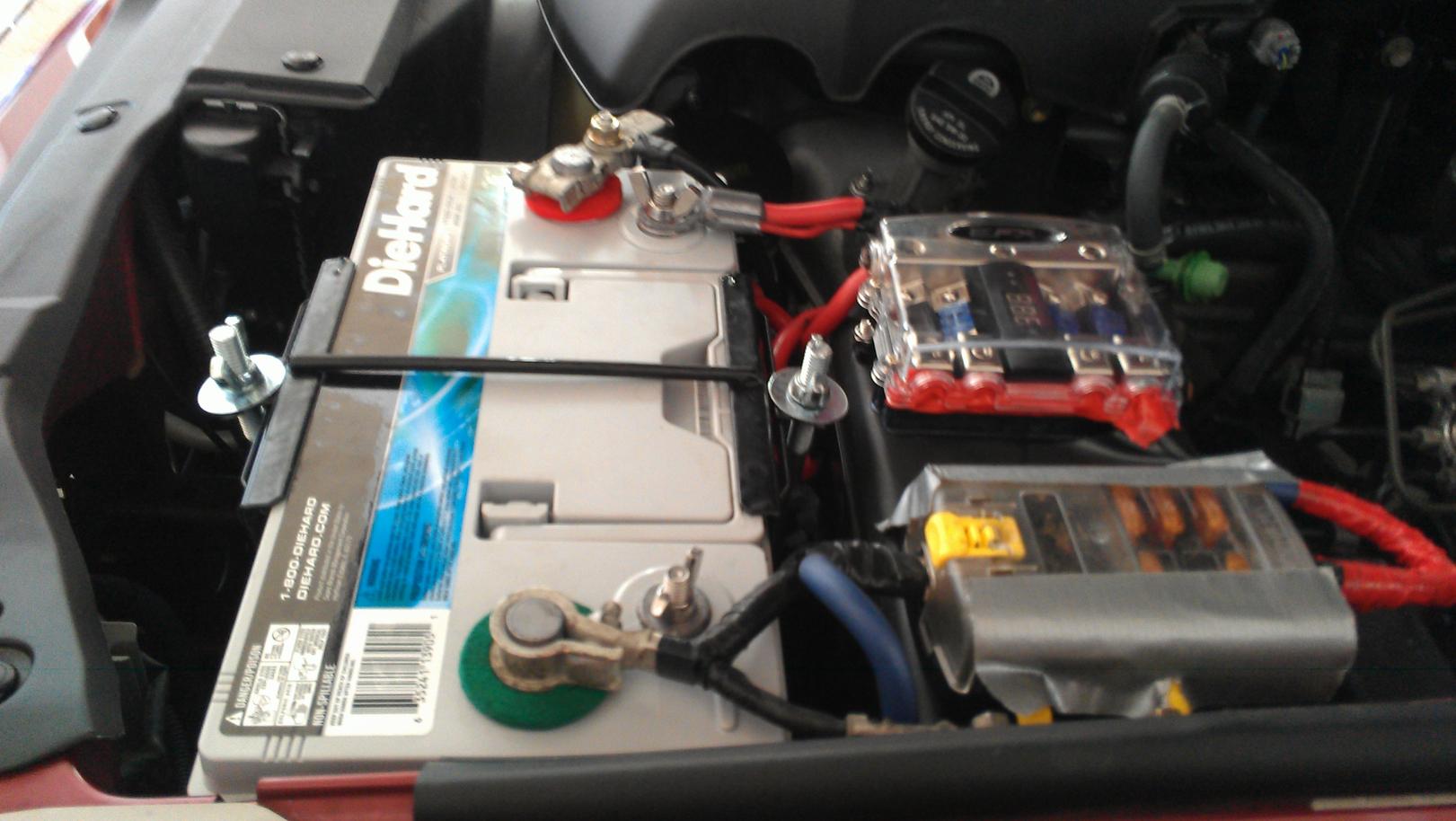

Wish I'd seen this thread earlier... I have the Diehard P34 (I think?) it bolted right in with no problems. Sears had it listed as a direct fit in their catalog.
Not a very good picture, but you can see the factory leads.
edit- the picture is huge for some reason, here's a link.
http://imageshack.us/photo/my-images/695/dsc0002ex.jpg/
It looks exactly like yours but grey instead of red.
