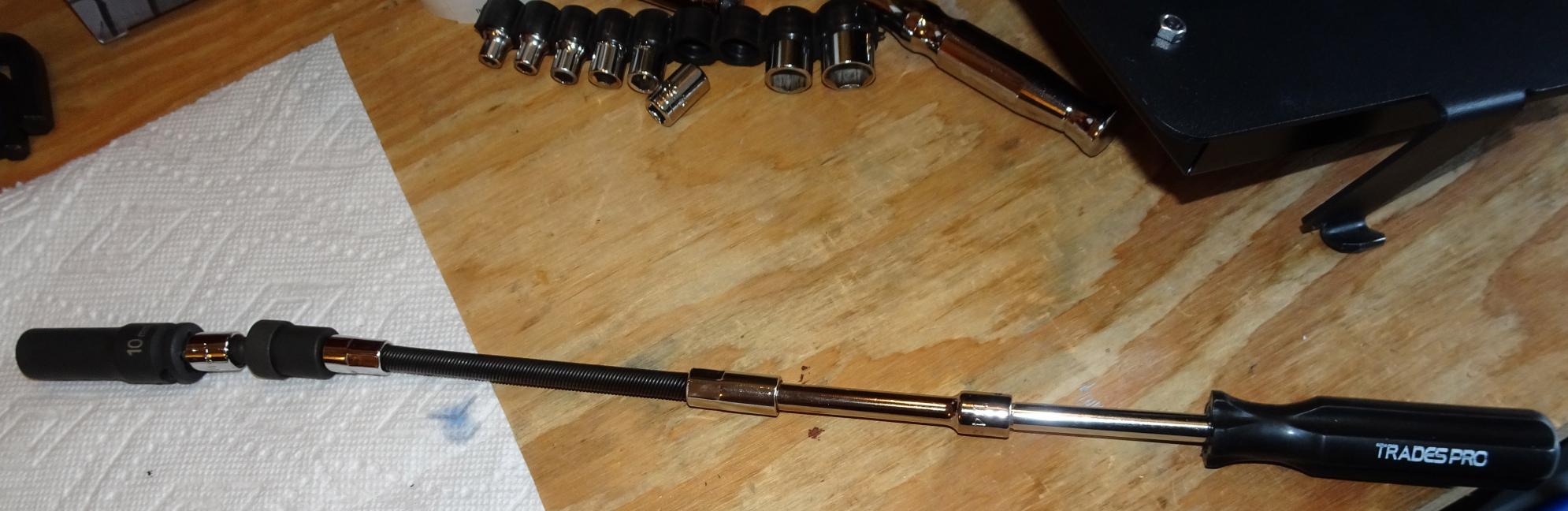

Thought I would follow-up on this. Just today I was finally able to swap the amp out. So far, it seems to have solved the cracking and popping with phone calls on bluetooth.
As for an install tip - get a small 10mm socket that can extend on a very small ratchet (smaller is easier to handle) and it will help with mounting the amp under the passenger seat.
As for getting the harness across behind the dash (which is a huge pain) I used fish tape to help with some duct tape around the harness and was a gentle as I could be... wasn't the easiest either time and tore my hands up a bit. But it works.

Totally agree on the fish tape in the dash, install video makes it look way easier than it actually is and the sharp sheet metal edges behind will slice up your hands easily. As for the under the passenger seat, I actually attached a flex shaft to a screw driver handle and used a 10mm universal joint to reach that tricky bolt for the amp bracket. Because the 10mmm socket on the end is magnetic, it held the bolt nicely while I fed it into the constricted space to seat it and tighten it down. I found a small tool box to rest the amp bracket on while getting the bolt in place so I didn't lose a hand in the process. (photo of my contraption below)...

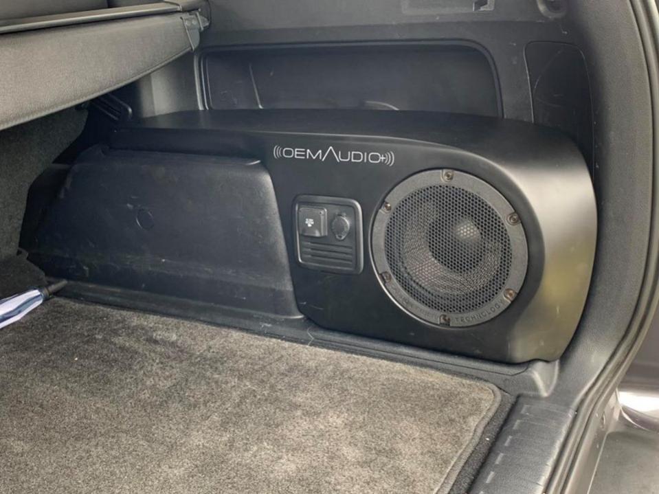

Finally heard it on Saturday at Toyotafest. The system they had there had dual 8" subs. The second sub will be out in a couple of months. They were really pushing the system hard at high volume. You can hear the subs straining a little to play bass heavy hip hop but overall I was impressed with the system. Had them play Welcome To Machine by Pink Floyd. They didn't expect the heavy bass intro.
I ended up purchasing and will get the 2nd sub when it comes out. The rear boxes look clean installed unlike having a regular box sitting in the cargo area or the TT box that blocks the rear seat from reclining completely and blocks the cargo cover provision. If you're trying to turn the bolts of the car next to you into liquid, this system is not for you.
Pic of the 2nd sub due out in a couple of months.

I couldn’t agree more. I had this system in my Tacoma and it rocked! In my 4Runner not so much. Not sure why your tailgate speakers don’t have tweeters, mine do. Also my front door speakers have a much smaller magnet then the 6.5s, my Tacoma fronts had the same size as the rest. The lack of tweeters in your tailgate makes me wonder how “optimized” there systems really are. This system is kinda low on power/watts total. Maybe it works for the smaller volume of the Tacoma better then the 4Runner? Overall I’m happy with the system but makes me wonder how much better it could have been with $$$ spent on something else. The pic is stock front door magnet vs theirs. I don’t have a pic of the rest but they’re about 5x larger
Wow. That magnet looks way smaller than the unboxing of the same system on youtube. I was about to place an order but this made me push the pause button. I attached a link to the YouTube unboxing from May of 2018. Magnet is 3 x’s larger on his 6 x 9.

Go to the 6:42 mark. What’s up with that?
Also, some of their pictures show the speaker in the rear doors as not having a tweeter but my understanding is they all should have a tweeter now. If you reach out to OEM A+ I would like to know what they say. Did something change when you purchased your package?

Smaller magnet is more efficient rare earth magnet... whole page about this earlier in the thread.
