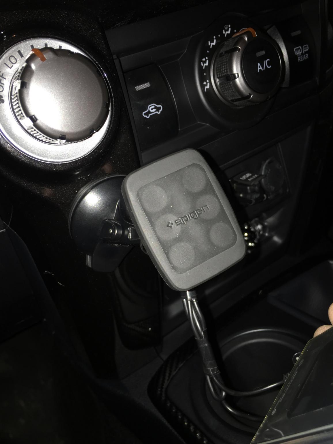

[MENTION=109703]niadh0[/MENTION]... curious how you player is being held in the pic.

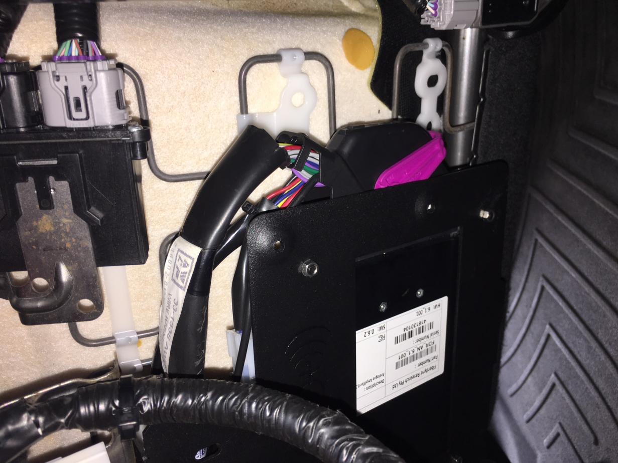

hi there, sure I can do but I rather you have call Daniel @ OEM+ first. That is because you may have a different model (silver vs black). I think the silver one was called 450(Q) and the black one is called 500Q. The firmware and the tuning file I was sent by Daniel were made for the Black 500Q amp. The advantage of calling OEM+ is that they will send you the right software and files that are needed for your specific amp. Doe this make sense? there is no download portal/website whereby you can simply download the files for a DIY job. Let me know.
attaching some pics.

as fort the mount, I wanted to keep the stereo cable short from the Fiio player to the Aux port. I actually have a 6 inch cable that i want to use but I have not found a good mounting solution yet. so here is what I did.
found a garmin GPS suction cup mount that has about 1.75inch/2inch suction cup on the base and has a small ball-joint on the other end. Mounted it just under the left hand side big knob. Then I took a part of SPIGEN magnetic mounts designed for phones. The back of the magnetic mount installs on a ball-joint of any kind. so I mounted that on the short Garmin base as you can see in the attached pic. then put a metal pate on the back of the hi-res player between the case and the player... and walla.... i have a tiny clutter-free solution that is good for now. then neatly made a wire combo with some electrical tape with two wires... USB-miniUSB and Stereo-AUX-to-Stereo-LineOut. connected both to the player....still working on finding better wires... or at least looking forward to heat-shrinking the wires so it is absolutely a clan setup. no wire comes in the way as there is no extra hang any where.

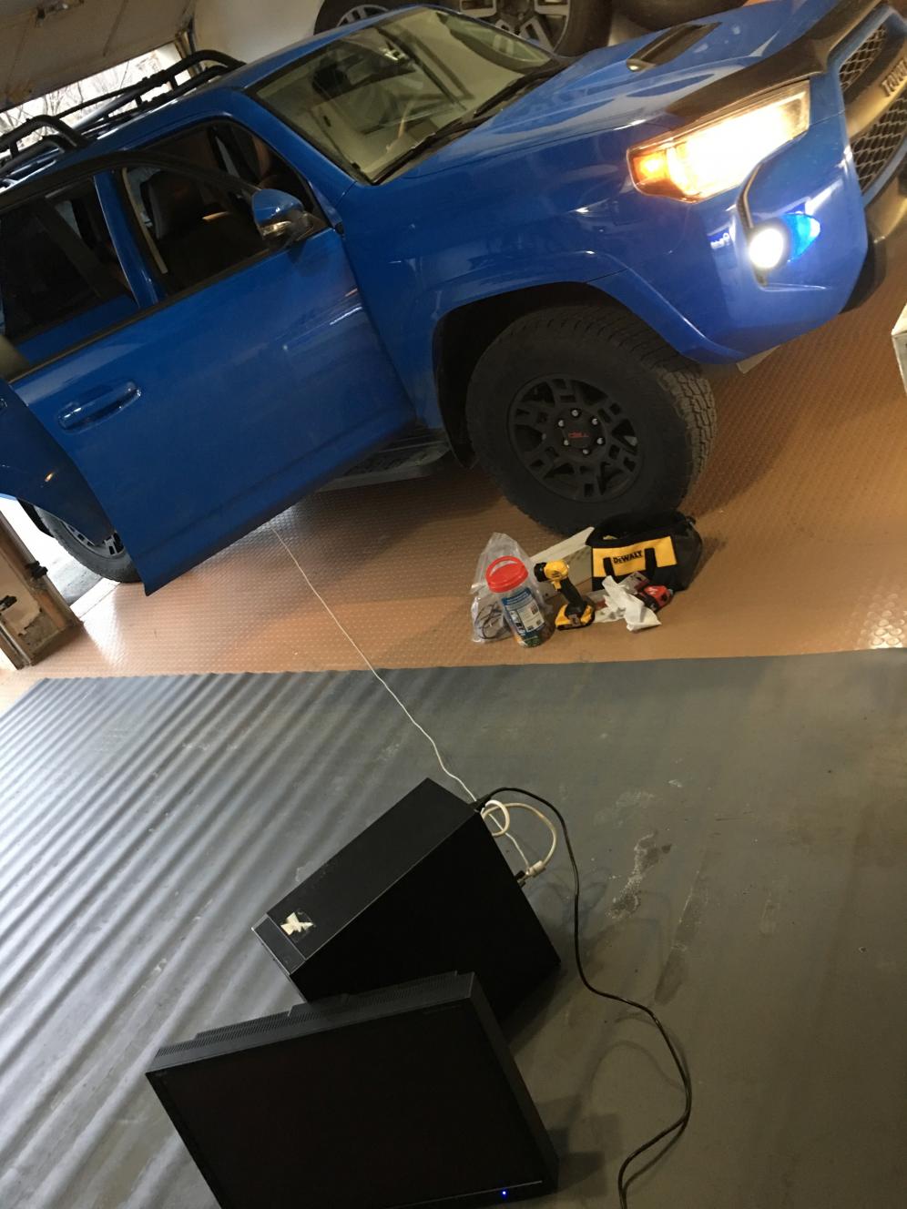

I contacted Daniel and he sent me an email with detailed instructions on how to get the firmware update downloaded and installed to the amplifier. It requires a Windows PC and I do not have a laptop, only a desktop. So I will be waiting until I have access to a laptop to be able to install.
LoL I faced the same issue as my whole family is a mac family and the only two windows machines in the house were desktops... i moved one in the garage as you can see in the pic
