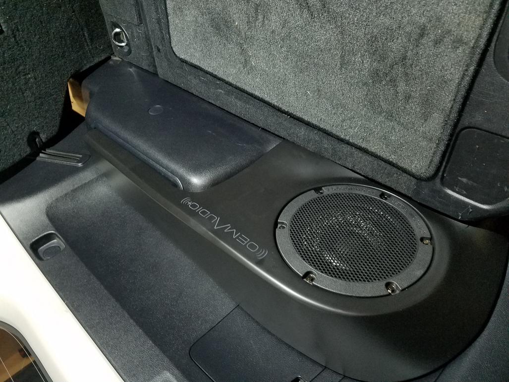

Does anyone have any pictures of the subwoofer installed? I'm trying to see how closely the color matches the factory black. The pictures on OEM's website seem to make it look darker and glossier than the factory plastic trim

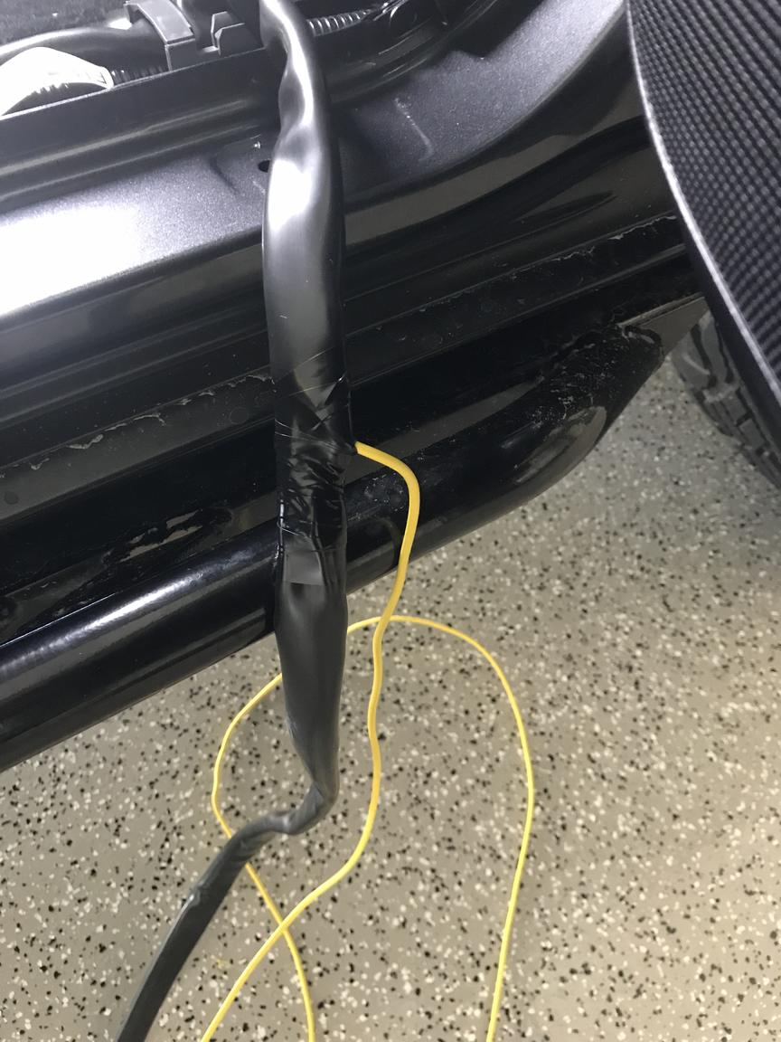

My power cable was sleeved into the harness as well. Had to cut it out of the harness a little ways back so that there was enough to make it through the firewall and to the battery. Everything else was very straight forward - and the video was extremely helpful.
thats exactly what i had. put some extra wire loom to be safe
guess i wasnt the only one

Does anyone know the reasoning with the subwoofer placement? Why couldn't it be on the other side? My Trail has an empty pocket there.....
they are working on a dual sub version if there is enough interest.
not sure if most / all 4runners have the outlets on the passenger side, would need relocating for a sub?
