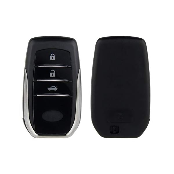

My solution was the EasyGuard EC002-T2 kit. The key fob is identical to the LandCruiser smart key
