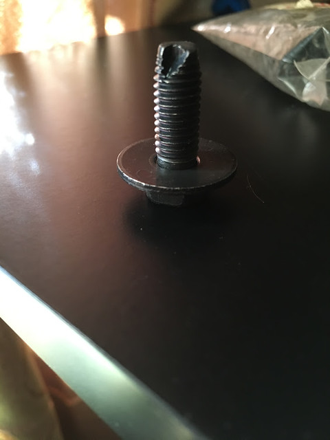

The bolts may have a little notch on them to clean the threads as they are installed, but they are definitely NOT self-tapping. At least, the stock ones aren't.
If you have something non-stock on there, that's a different story...

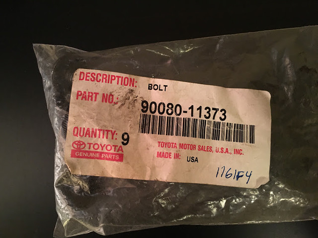

I bought the 5 front skid plate bolts from the dealer for $5 and change total.

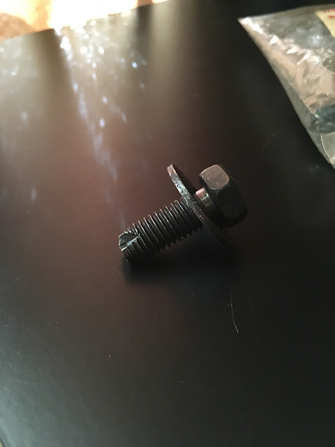

Thanks all for the input.
-Charlie
That's just how I'd heard other people refer to them. I think they're OEM.
