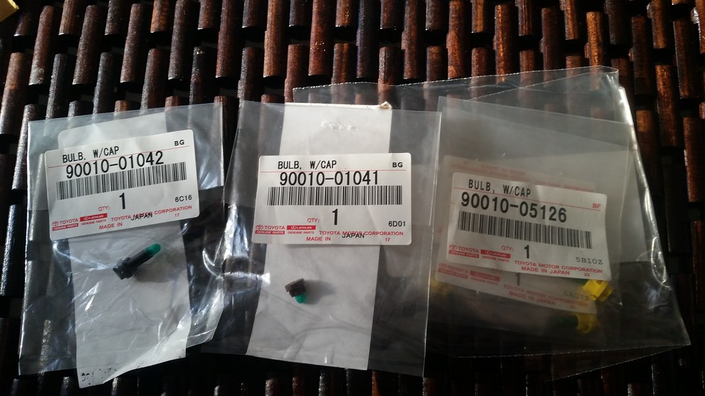

Here are all the part numbers

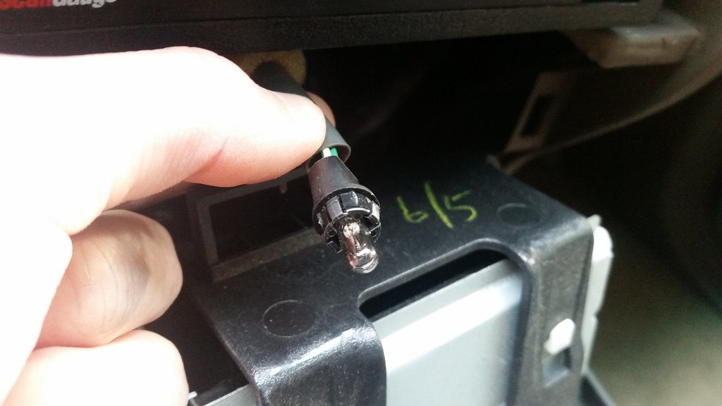

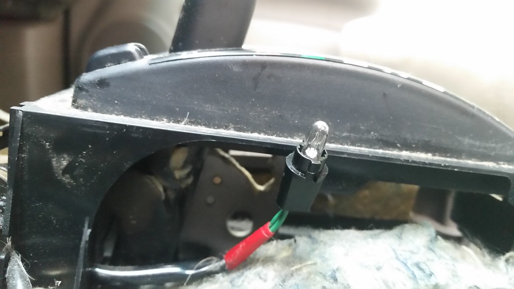

Replaced trans shifter light and ash tray #74 bulbs. 1/4 turn and pull out

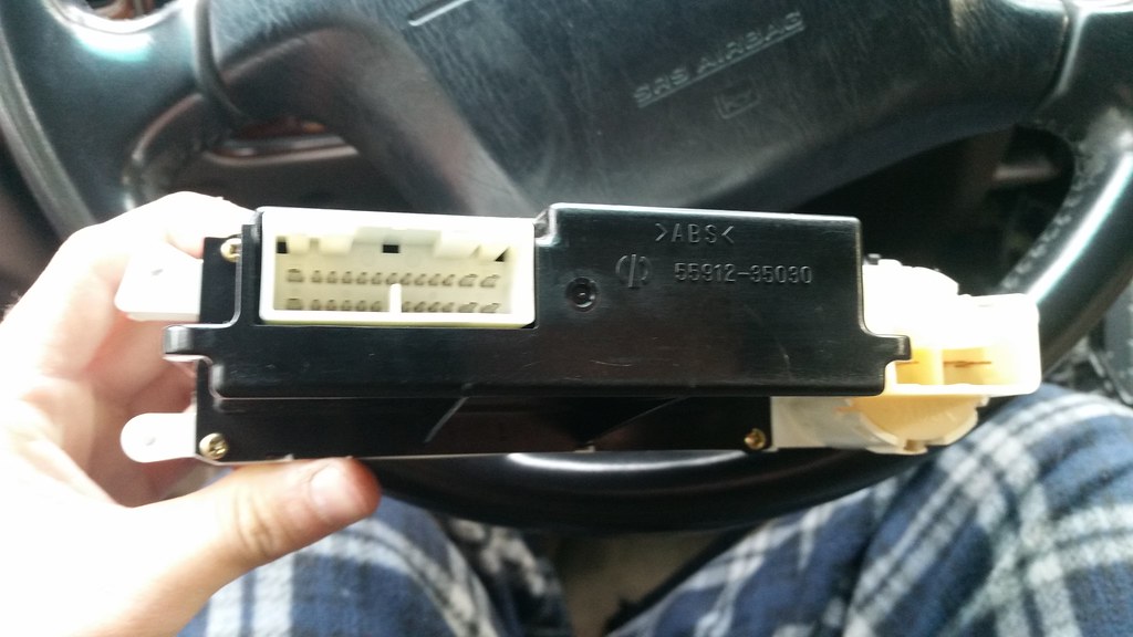

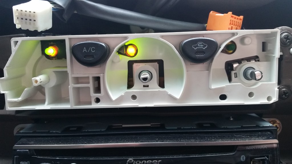

The light that was out for the climate controls
20161029_092200 by Kyle Murtha, on Flickr

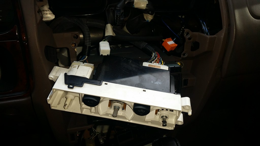

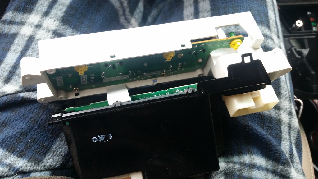

Disconnect the two white plugs on the back
20161029_092517 by Kyle Murtha, on Flickr
Remove 3 screws with screwdriver
20161029_092759 by Kyle Murtha, on Flickr
20161029_093442 by Kyle Murtha, on Flickr
1/4 turn and remove
20161029_092732 by Kyle Murtha, on Flickr

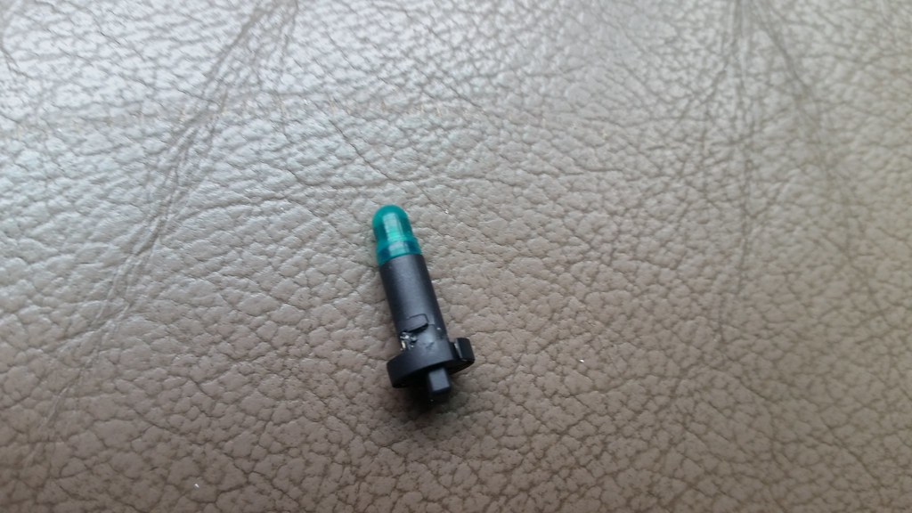

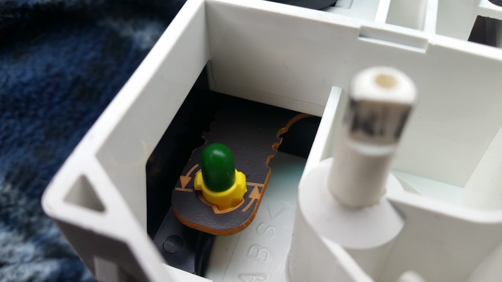

Toyota "specialty bulb" These were hard to find the part #'s for

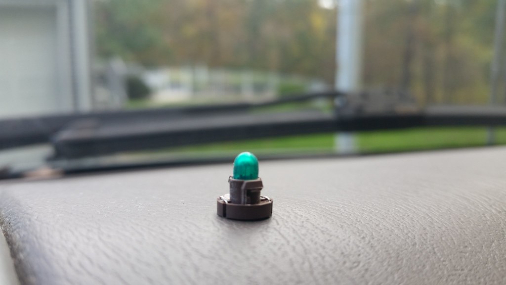

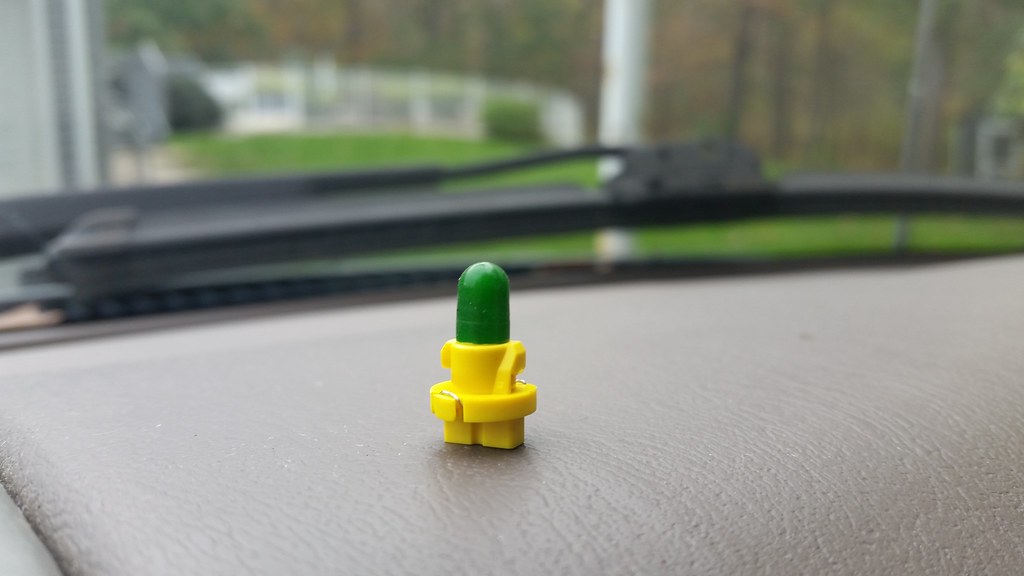

Didn't get any pictures of taking these lights out, but this is the bulb for the defrost and ECT button
20161029_101236 by Kyle Murtha, on Flickr

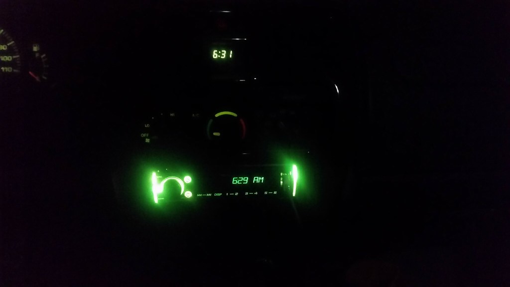

Before
20161104_063005 by Kyle Murtha, on Flickr

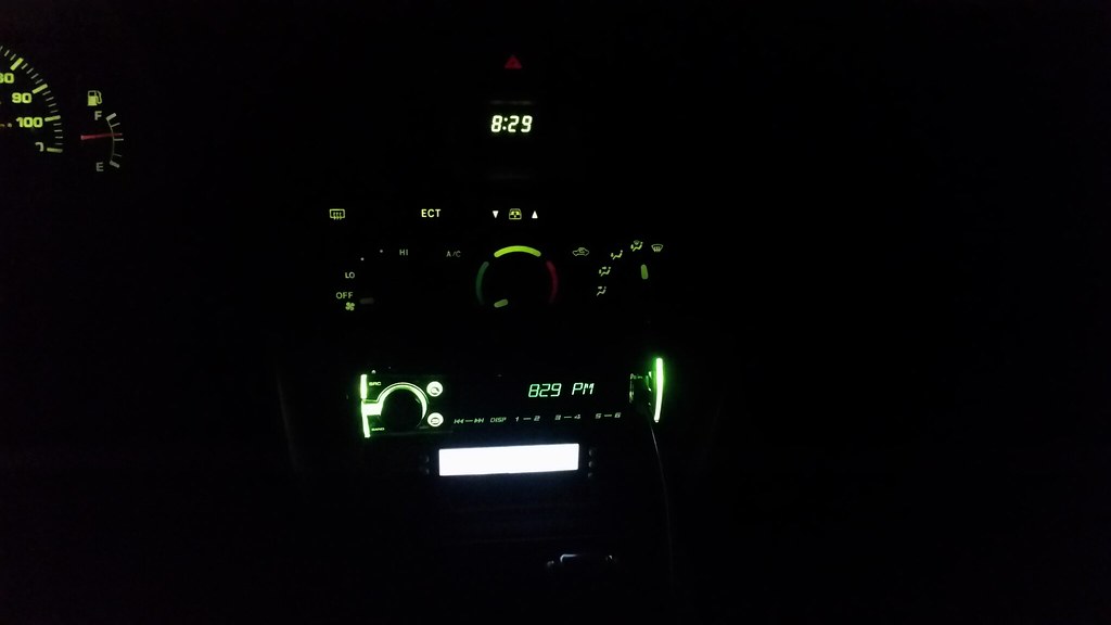

After
20161105_202945 by Kyle Murtha, on Flickr
