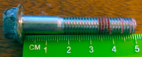

The OEM 4th gen roof rail bolt part number is 63230-42010. Hardware stores carry a M8 50mm (1.25 thread pitch) which is similar.
Note: The 50mm length is required to attach OEM roof rails. A different bolt length may be required for aftermarket applications.
