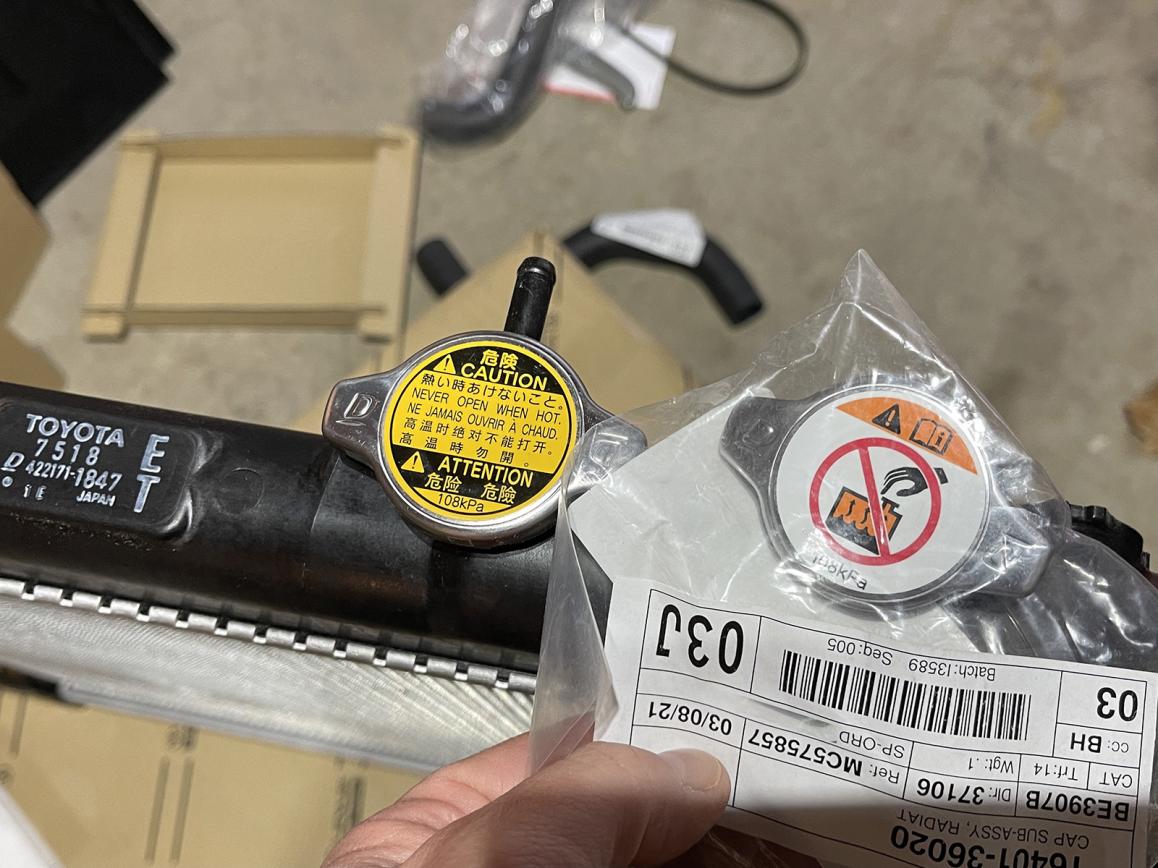

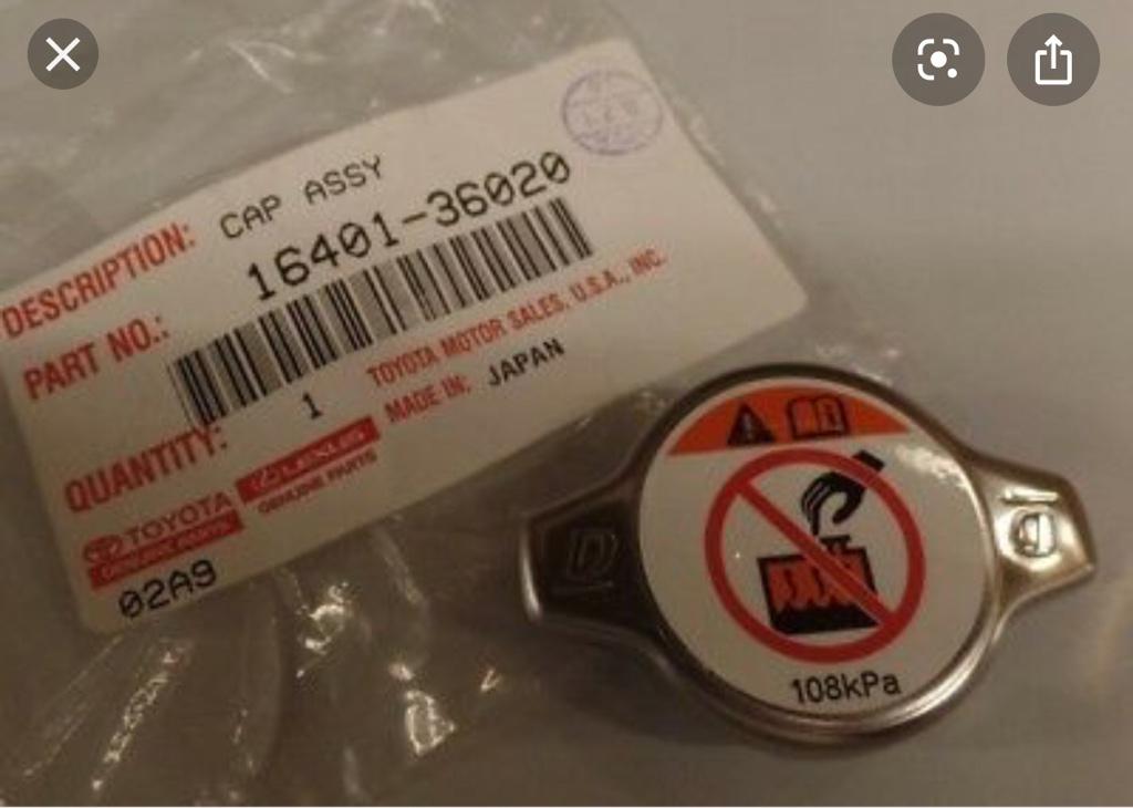

also...for fun...in the posts above have pictures of dealer supplied rad caps, both have "D" on them...like maybe denso ?
However you go to ebay or amazon and look at "genuine" radaitaor caps, none have the "D"

Just ordered part number 16401-36020 from camelbacktoyota. Does this cap have the Japanese writing on it or does it look like what’s on the pic. I may cancel the order if this is what it looks like. It’s for my 2001 4runner. a¥

I picked up a new Denso Japanese radiator the other day and didn't think it would come with a cap so I ordered one. Apparently, people forgot how to read at some point and Toyota revised the label.
