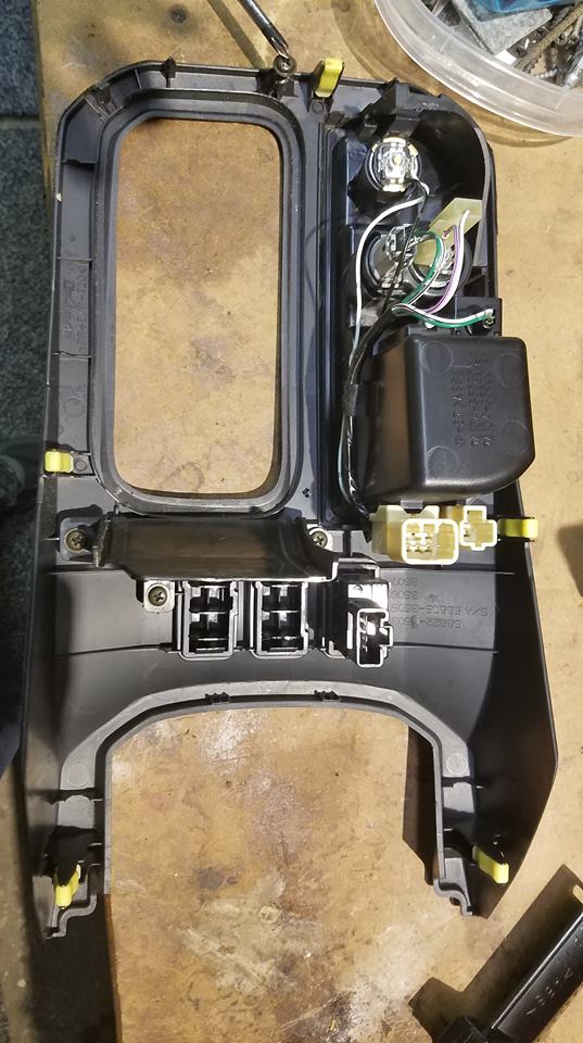

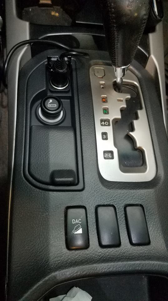

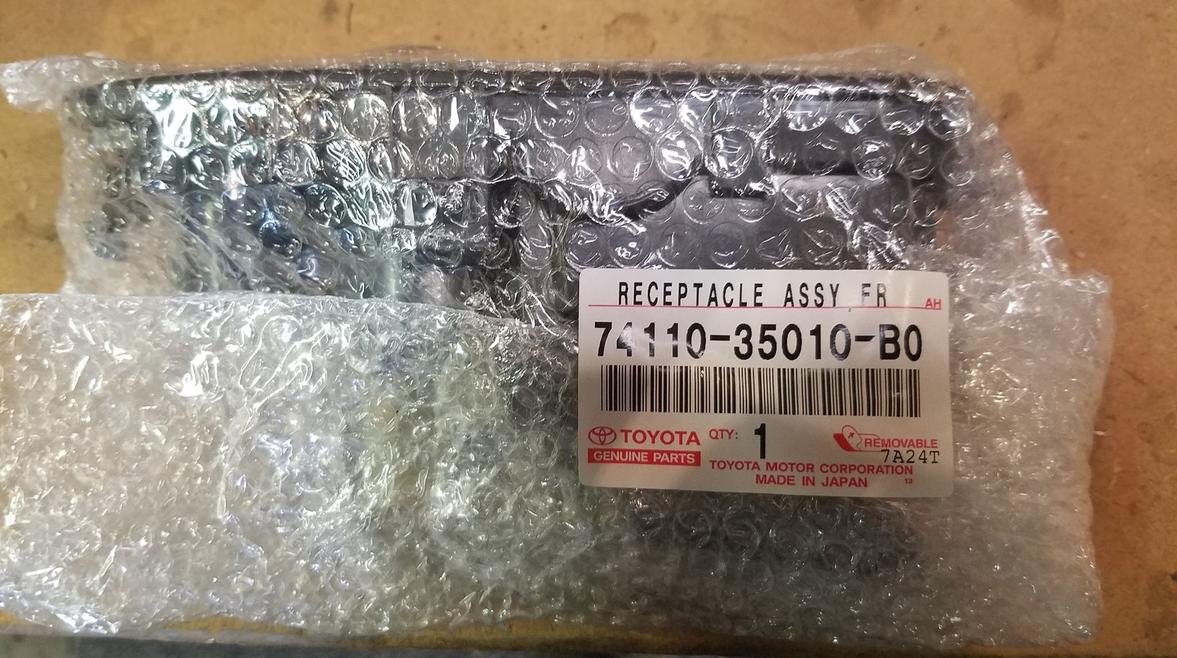

Amazon sells this OEM piece for 20 bucks prime. Its a direct plug and play, the addition plug is taped into the harness under the console. Simply untape it and plug it in.
1. carefully and clip console panel by pulling straight up on each end, making sure your center console box is open.

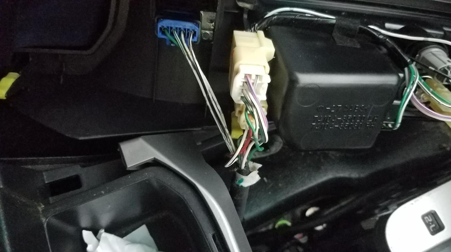

2. flip over panel you just removed and unplug 2 plugs, one of them being the DAC control. If the button falls out it just pops back in.
3. Undo 2 Phillips head screws holding an inner trim piece to the old console panel and remove black trim piece.
4. carefully unclip old panel and pop it out.

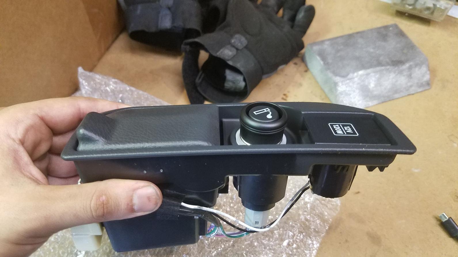

5. Pop in new OEM smokers kit panel. Reinstall both screws without inner trim piece.
6. Untape plug from harness in console and plug in all 3 plugs now including DAC button.
7. carefully snap console back into place and enjoy a clean look with extra power port.
