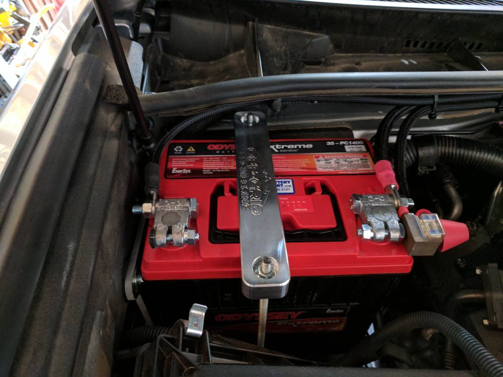

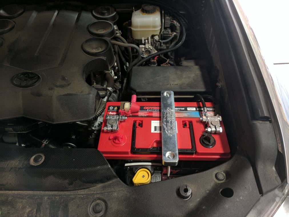

Here is my install with the starter battery relocated to the passenger side. All of the factory accessories still run off the starter battery. Any factory accessories you want to run off the accessory battery would need to be rewired.

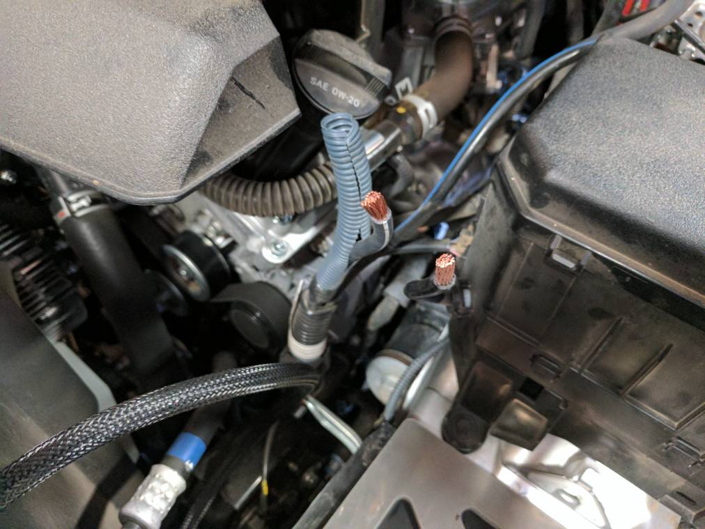

Did you connect the two bare wires coming from the alternator and going to the fuse box together?

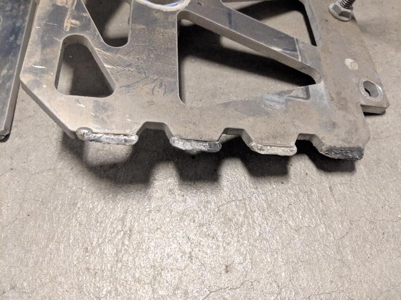

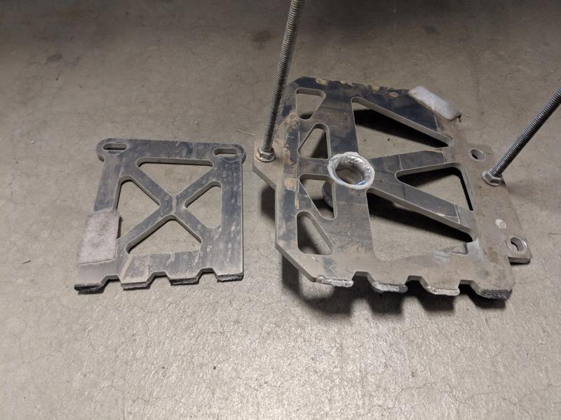

For anyone interested in this kit. I started to notice a noise coming from my passenger side the last few weeks. Initially thought it was from my roof rack or cowling. Tightened everything down and the noise was still persistent. Opened the hood up and noticed my aux battery was shaking a bit. Thought the hold bracket might be loose but it was pretty tight. Took everything apart and noticed the tray broke at the weld. The unfortunate part is that it also broke one of the weld tabs on the oem support bracket the aux tray sits on. I'll fix that with some JB weld. Thing is I haven't been on dirt for the last 6 months since it's winter here. So I'm very surprised and shocked it broke. We have cold winters here and springs just starting to hit spring so maybe the recent weather change lead to some metal fatigue.
Just thought I'd share this here. Not sure if it was just my particular unit that's bad but disappointing none-the-less. I don't know what direction I'll go with next but I won't be going with their aux tray. I'm either going to get a steel aux tray in the same location, the shrockworks tray or go single large battery.
