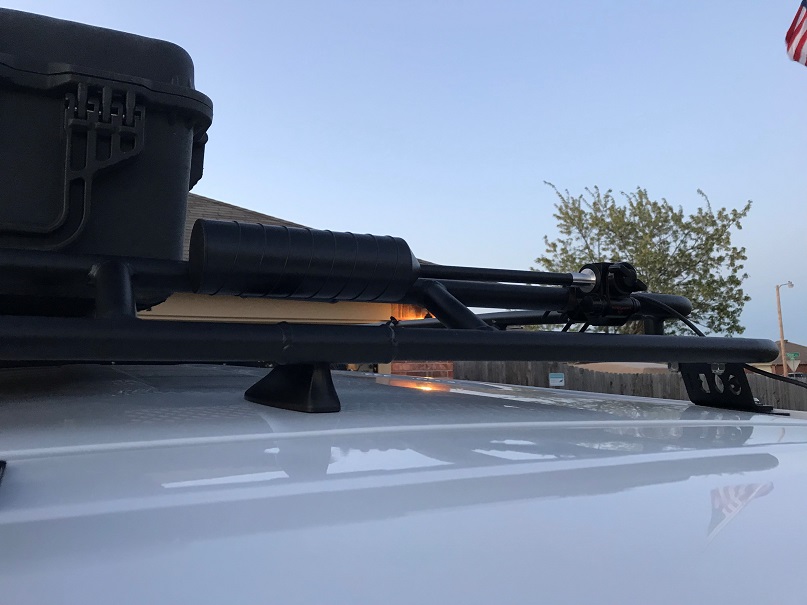

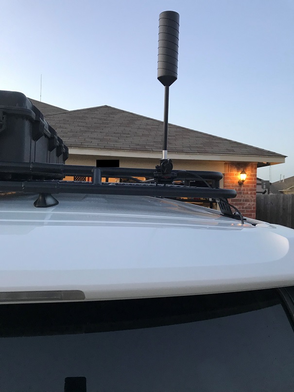

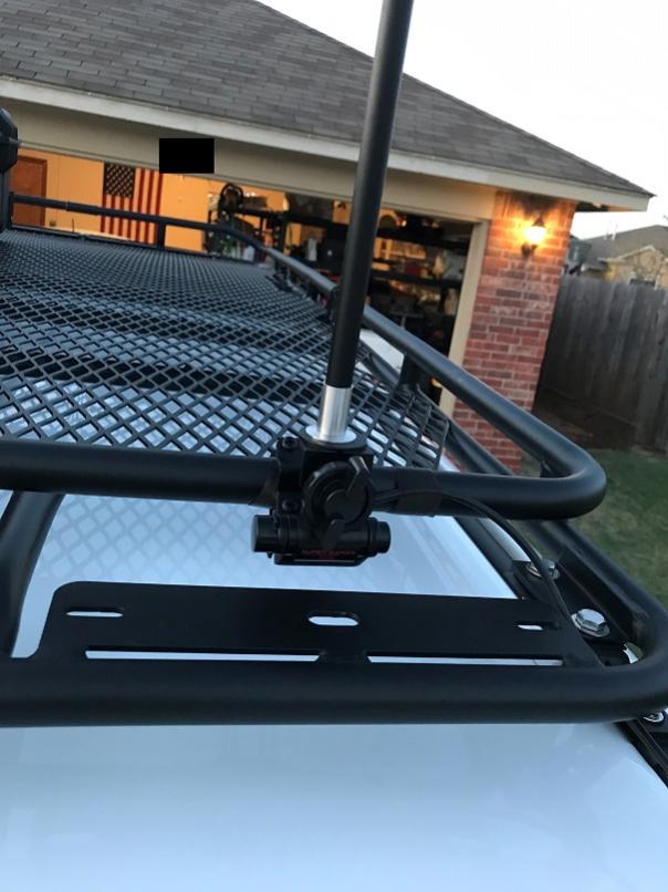

I just installed one.
We have some rural land that has a few areas where I lose service.
Turning the booster on will give me two bars in these dead areas and I get data and can make a call just fine.
We will be making a trip to some remote areas in about a month and Ill see what it does out there.
So far it looks good you just need to have reasonable expectations.
Where did you mount it? The rig looks SO awesome!
I mounted it on the back of the GOBI rack with a Diamond K540 mount.
I used the washer and nut they provided with the booster kit...

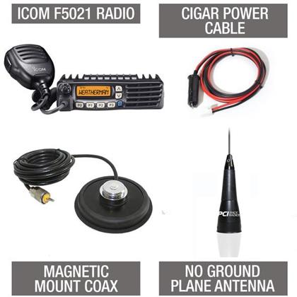

This is the exact system 95% off offroad race teams use for their chase trucks and base camps. It uses a Japanese made ICON radio, which is much higher quality then the Rugged stuff. Magnetic antenna and cigar power wire mean this is easy to throw in the rig for a weekend trip, and easily removed for storage.
Whether you’re part of a race team or out playing with friends the PCI Chase Package is a great way to stay in contact. Great for base camp set ups or chase vehicles. Programmed with Weatherman’s Stock frequency list, or we can add your personal frequencies.
Icom F5021 VHF Mobile Radio. 50 Watts of power, 128 Channels, alphanumeric display. Complete with bracket, Hand Mic and Power cable.
No Ground Plane Antenna
Magnetic Mount coax package includes cigar power cable.
Radio Type: Mobile VHF Radio
Frequency Range: 136–174 MHz
Number of channels: 128 channels / 8 Zones
Current Drain: TX 50w vhf 10.0A
RX Max Audio 1.2A
Stand-by 300 mA
Power Supply Voltage: 13.6v DC
Dimensions (WxHxD) 5-29/32 × 1-9/16 × 6-19/32 inches.
Weight: 2.4lb
Output Power: 50w @ 13.6v DC
Supplied Accessories: Hand microphone (HM-152), DC power cable, Mounting bracket kit, Microphone hanger , Key assign sticker
PCI is not a frequency coordinator. We recommend using Forest Industries Telecommunications and they have set up a portal to obtain a license here
