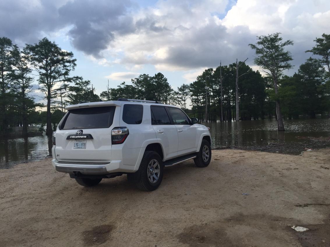

Hello All,
So I finally made the jump and bought a brand new 4Runner (2015 TE) This is not only my first 4Runner but my first off road vehicle. I've been into cars and bikes for a long time so of course I've got that itch to do some aftermarket work ... But I'm not sure where to start. Honestly I've never even been off roading before and I could use a run down on the basics ( I got myself stuck a few weeks ago, now I second guess everything ). I live in North Mississippi, if anybody's familiar with the terrain I'd love some pointers. I know this is more of an interdiction but I kind of figure I need help from people that know the stock setup personally.
Thanks all. Look forward to being a part of the community.

Great looking truck.

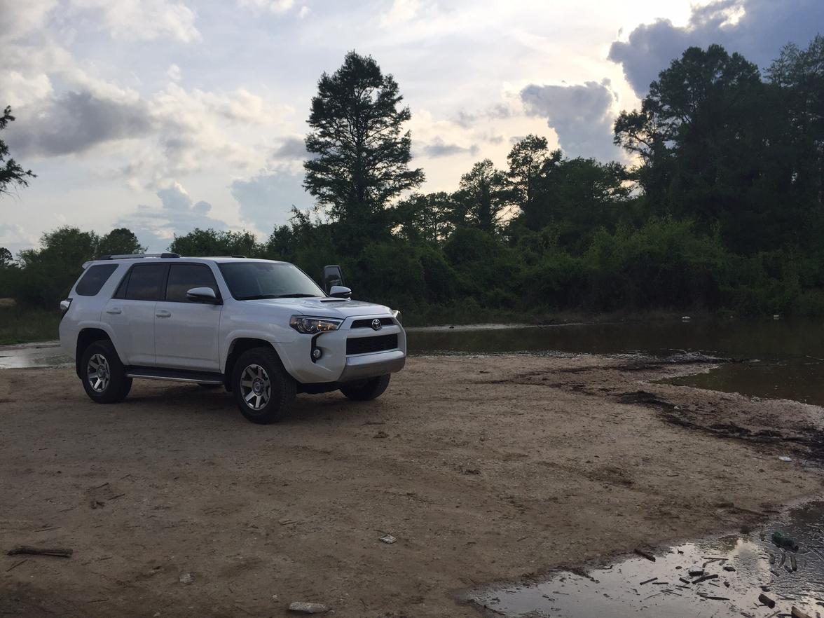

Hey thanks for all the great information everyone. I really appreciate the quick response time and the all knowledge that I already have to gained. I was worried I was gonna get blasted, I'm gonna look for some groups if anybody else see this and is in the area of Oxford or a couple hours Id like to maybe meet up and get some in field pointers.
