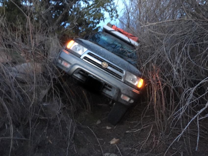

I had my roof tent (141 lbs), a 43 lbs table/bench, 8 gals of fuel (~50 lbs) plus the weight of the rack itself. Probably over 260 lbs on the roof and I didn't fall over. Now, was I extremely unhappy about being in this spot? Yes, yes I was. And it took a while to get the foam to sit flat again after the point it was formed in to.

I had my roof tent (141 lbs), a 43 lbs table/bench, 8 gals of fuel (17 lbs) plus the weight of the rack itself. Probably over 230 lbs on the roof and I didn't fall over. Now, was I extremely unhappy about being in this spot? Yes, yes I was. And it took a while to get the foam to sit flat again after the point it was formed in to.
I think 8 gals. of fuel would be closer to 50 lbs.
