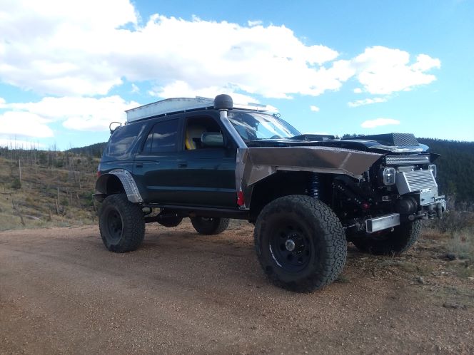

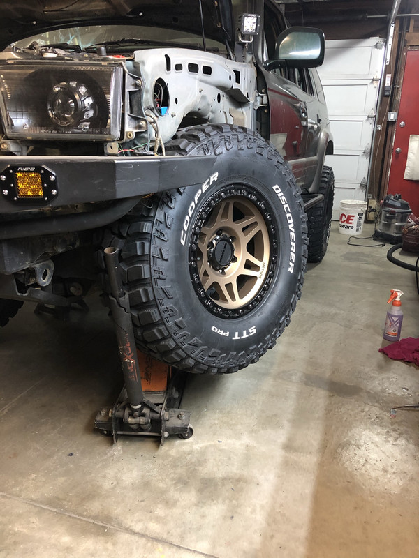

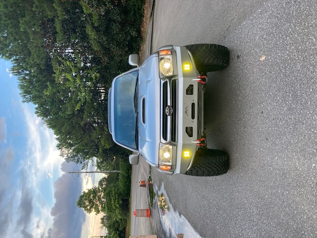

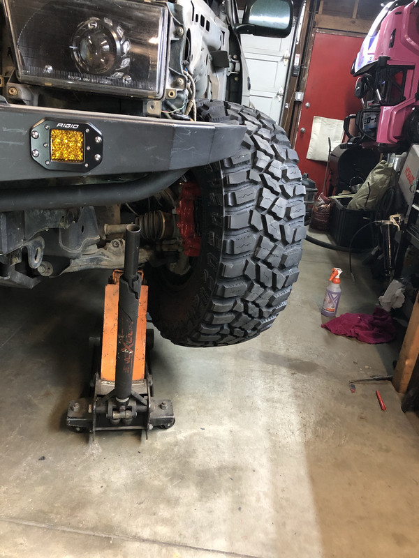

- What wheels are you running? Method 312’s (0/4.75 17x8.5)
- Do you rub the frame at full lock? No
- What specific tire size and brand are you running? 315/70/17 cooper STT pro’s
- Do you rub the UCA at full drop? No JBA’s
- Are you running wheel spacers, if so how big are they? 1” Bora spacers
- Are you running a body lift, if so how much? 1” Toytec
- Auto or manual, and what R&P gears are you running? Auto, 5.29 gears Air locker front/E-locker rear

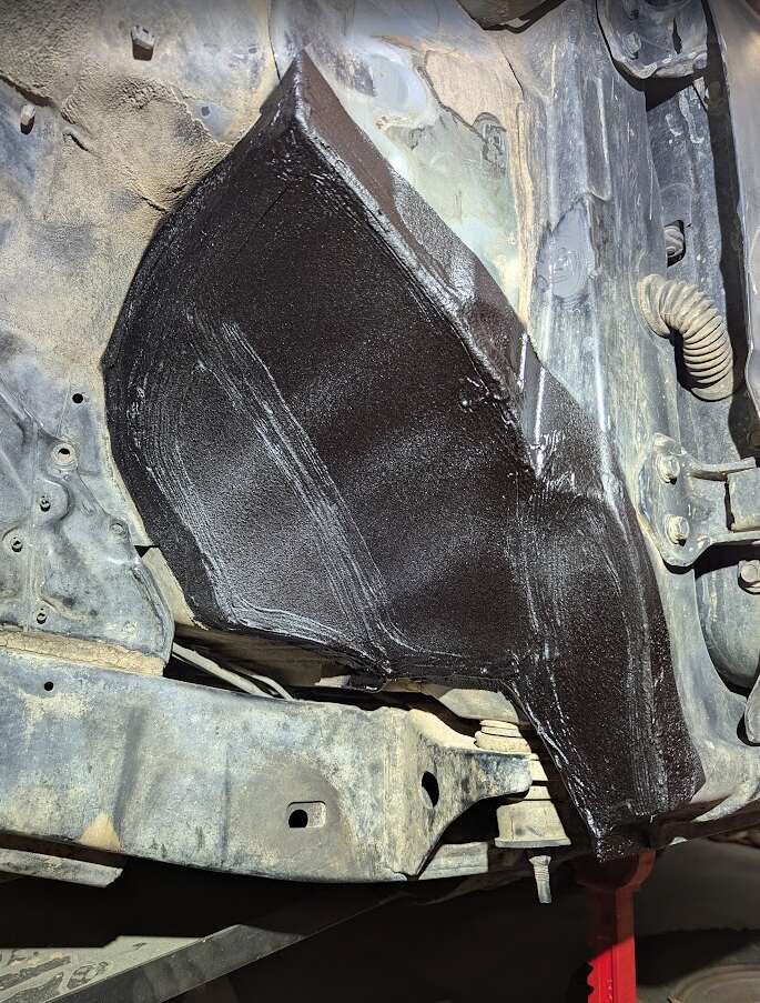

Scarab windshield kit. Tubbed for the tires then installed 1” body lift so hopefully won’t have to do much if I ever go to 37’s. Removed coilovers and bump stops to check clearance at full bump/lock.

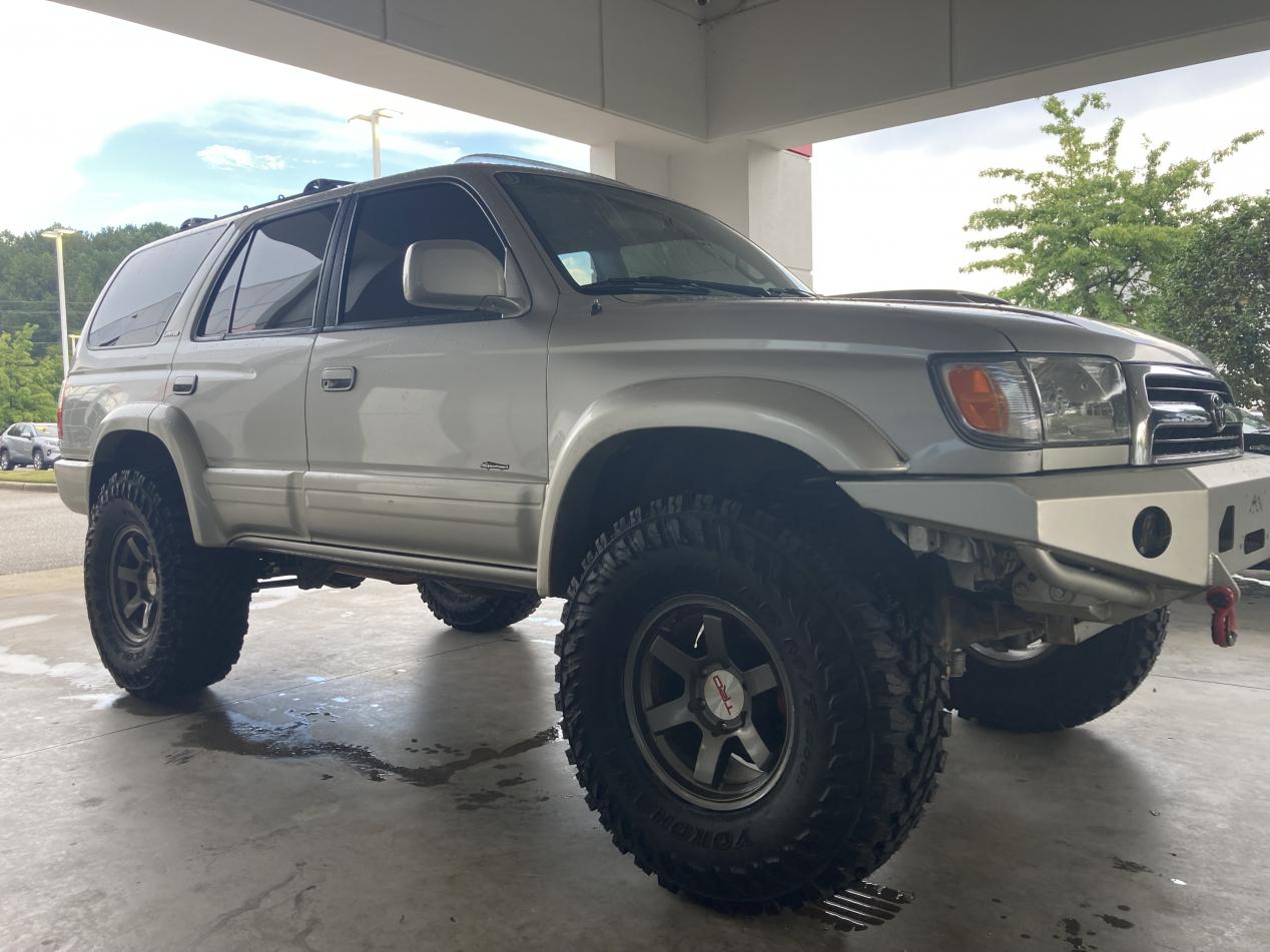

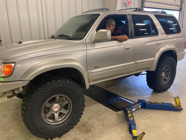

- What wheels are you running? Level 8 MK6 16x8 -10 bs
- Do you rub the frame at full lock? Yes
- What specific tire size and brand are you running? 315/75/16 Yokohama Geolander MT
- Do you rub the UCA at full drop? No, SPC UCA's
- Are you running wheel spacers, if so how big are they? No
- Are you running a body lift, if so how much? No
- Auto or manual, and what R&P gears are you running? Auto, 4.30's

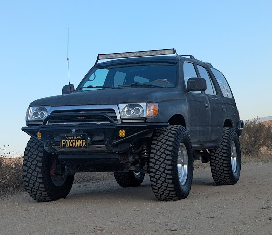

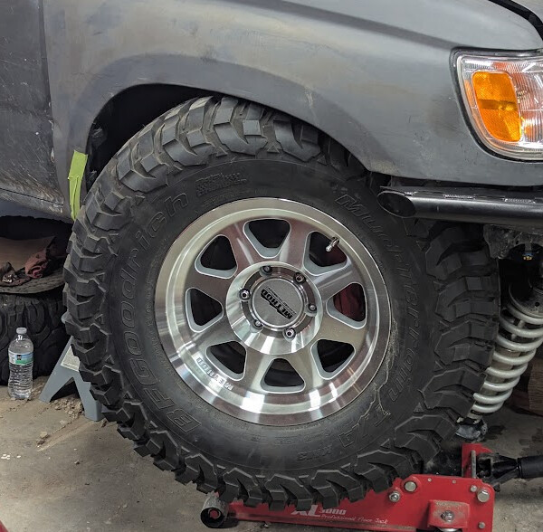

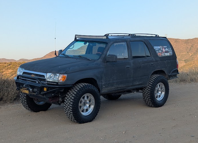

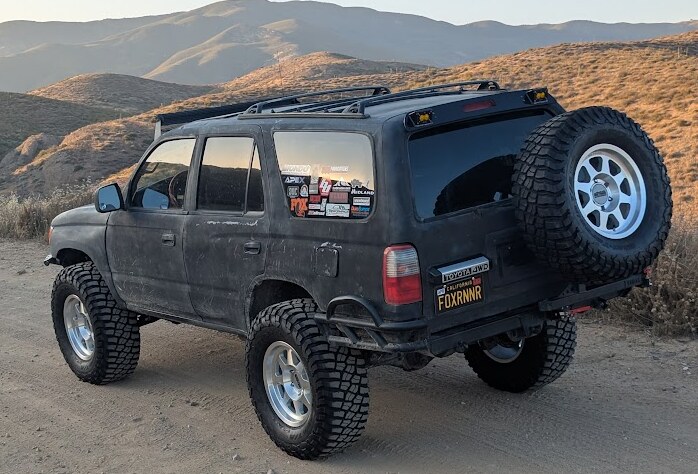

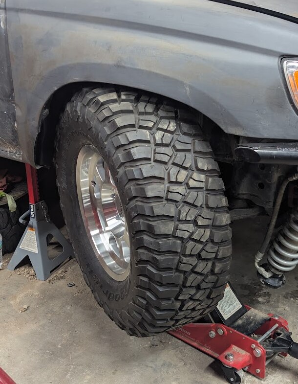

- What wheels are you running? Method MR701 bead grip 17x8.5 +0mm offset
- What specific tire size and brand are you running? 35X12.50R17 BF Goodrich KM3 M/T
- Do you rub the UCA at full drop? No, JBA UCA's
- Are you running wheel spacers, if so how big are they? Yes, 12mm
- Are you running a body lift, if so how much? No, firewall tubbed
- Auto or manual, and what R&P gears are you running? Auto, 4.10's
