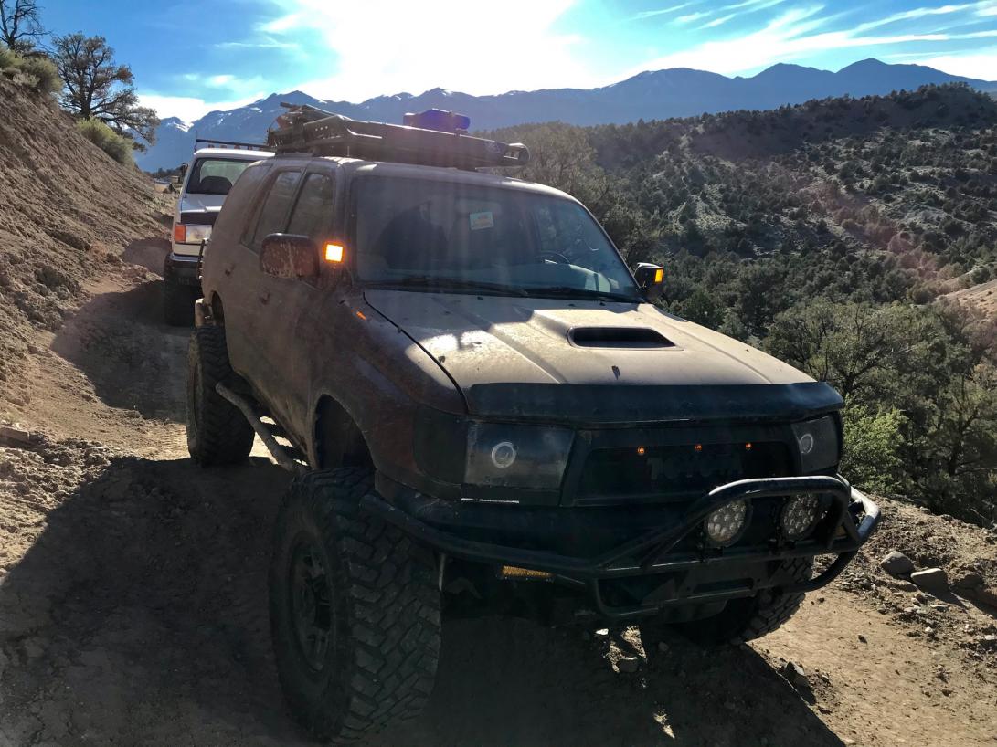

35x12.5x15 General Grabber X3

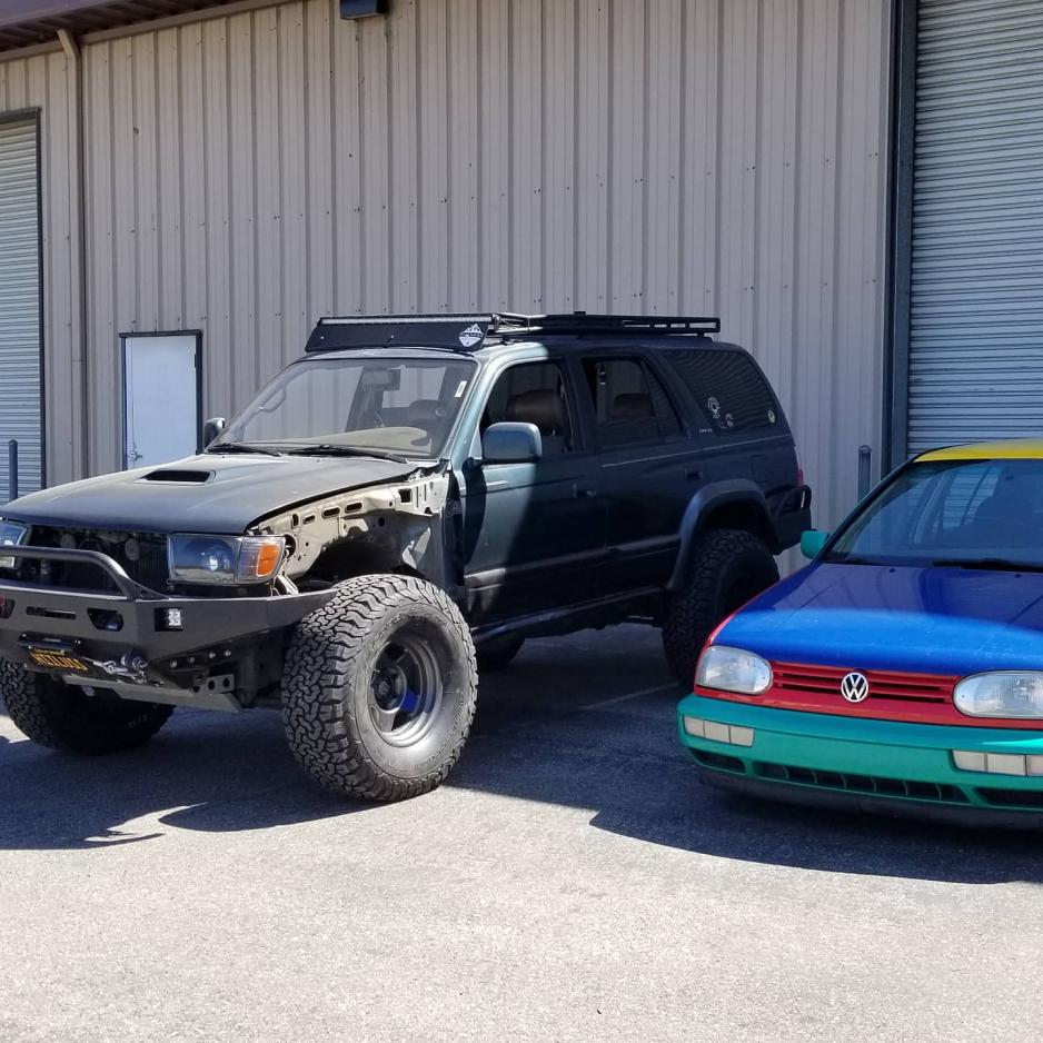

I joined the club
Do you rub the frame at full lock? Yes
What specific tire size and brand are you running? 315/75/16 Toyo MT on Fuel Ripper 16x8. 4.5 bs
Do you rub the UCA at full drop? No. SPC UCA's
Are you running wheel spacers, if so how big are they? No
Are you running a body lift, if so how much? No. Cut this. Welded that.
Auto or manual, and what R&P gears are you running? Auto, stock 4.10
