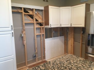

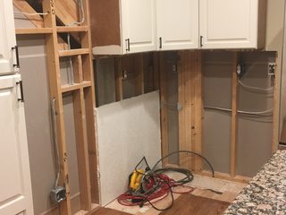

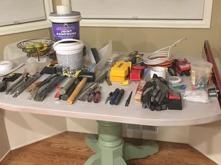

Not done yet, but phase 1 of kitchen remodel is "almost" complete. Moved range, micro and refer to new location. Moved the 220, 110, and H20 to new locations. Unfortunately, new cabinets have a different reveal so we have to trouble shoot before we install. Once this is resolved we're going to add some cabinets to make the island larger (phase 2). Once island is "bigger" we will be ordering new countertops and then the wife takes over with installing the new backsplash.
Sadly, I think I have more tools to work on this stuff than I do to work on my T4R! :lol:
...and of course I used my 4Runner to get the materials, cabinets, and drywall!

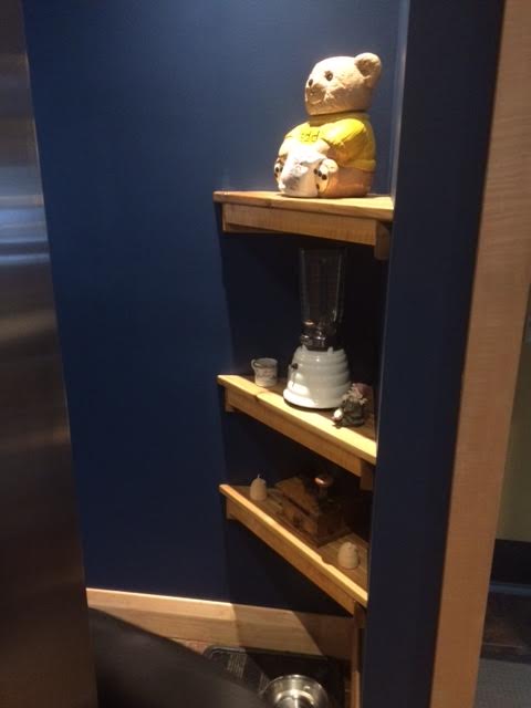

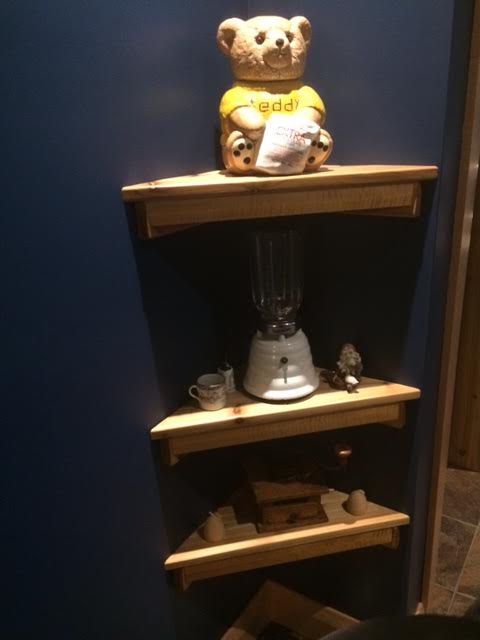

Our kitchen had a small dead corner space, only suitable for the dogs water & food dish, on floor.
But the stub wall needed to be spruced up, so an artifacts shelf was custom framed - to hold family heirlooms.
a) made out of scrap wood, from curly maple & cedar cutoffs
Top shelf - holds Moms cookie jar, a Xmas present (from decades ago)
Mid shelf - Oster beehive blender, granny used to make milk shakes in, for us kids / using icecream, coca & raw egg
Bottom shelf - My dads coffee grinder he got from his GF / used it to grind grain for pet guinea pigs on the family farm

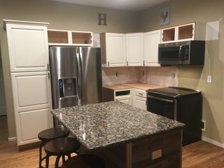

New cabinets and island installed! Time to order counter tops, paint cabinets, and install the backsplash.

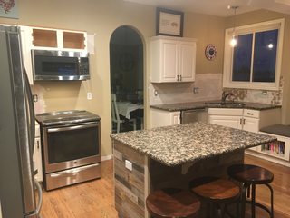

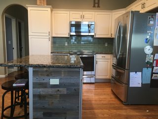

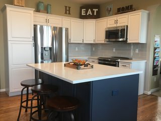

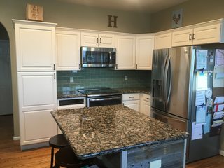

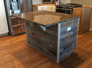

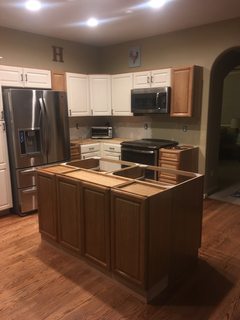

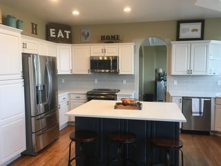

...and the kitchen is done!!!
A couple pics from the completed kitchen.
Done #1
Done #2
Before #1
Before #2
Next project...installing sliders on my 4th gen, unless my wife wants to do something else around the house! lol

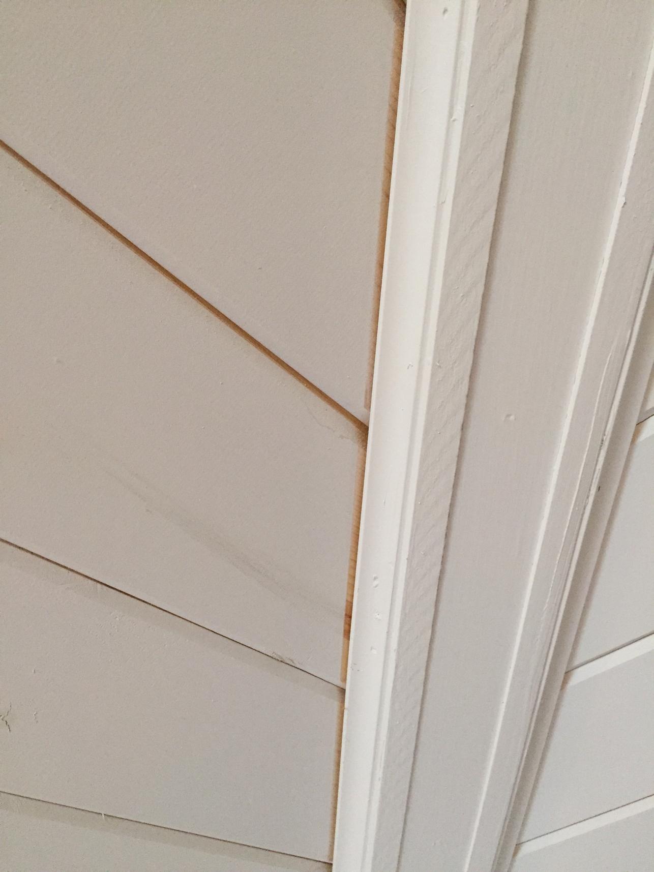

[MENTION=84680]wadle5[/MENTION] You may want to pop that trim off there, paint, then put the trim back on. The wood will expand and contract with the seasons. After I did my ceiling, of course after...., I talked to a guy that does it for a living. They paint the boards before install to avoid seeing the unpainted joints like I have in the winter on mine. If you caulk yours only caulk along the wall, the caulk will crack on the wood side when the humidity changes in the room.
Also if you do more of that and don't want to fill nail holes, you can blind nail it on the tongue part and its covered up by the next groove piece. See Russ, no nails!

Legit! brilliant fix on nailing on the tongue. I was wondering about the caulk or even if it was necessary and I guess we will just wait for now. Get it all painted later this week then go from there. Thanks for the quick tip though, totally makes sense.
