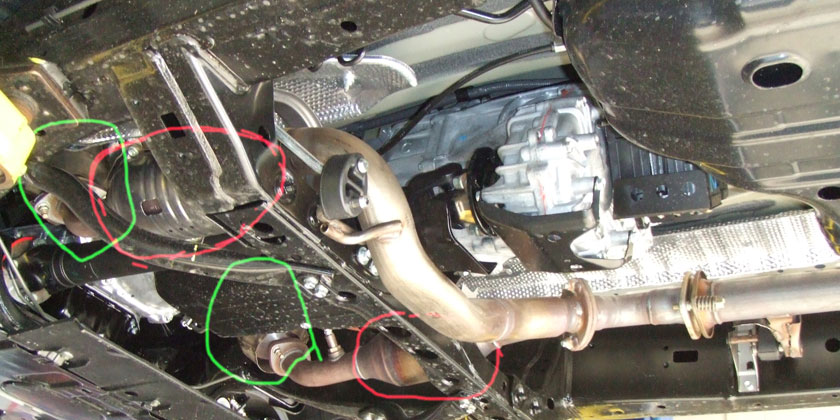

the ideal Y would start after the exhuast manifold pipe and end right where the cat-back exhaust starts. less flanges this way too.
in the process, 2 pre-cats should be deleted.
cat delete or pre-cat delete?
cuz there are still o2 sniffers after the cat.
here's a picture of what i mean.
the red circle is the pre-cat or resonator which can be eliminated and i was thinking that would be eliminated on a new Y pipe.
the green is the cat and there are sensors after them, if the new piping does not have that, then i feel a CEL would be set off due to too much emissions.
you would still need something to interrupt the signal from the 02 sensor to the ECU as there would be somethign like a "Catalytic Converter Inefficiency" code thrown considering that there would be 0 scrubbing of emissions.
if its just for the 1st section midpipe (with the secondary cats) then we wont need any sort of 02 simulators, but if its to replace all the cats...then we will.
