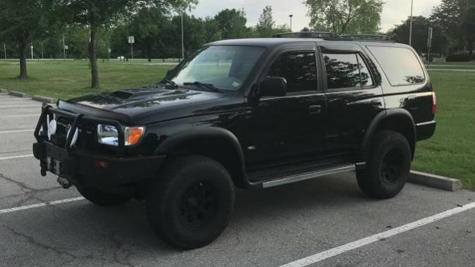

Need some advice. My son and I were changing the oil in his 1999 Toyota 4Runner Highlander Edition. For some reason it had a 10mm oil plug and needed a 10mm gasket. I'm guessing the previous owner might have stripped it and put a threaded insert in it???
We found a 10mm copper gasket at a local auto parts store and went to torque it down to spec and now the oil plug won't tighten or un-tighten I'm thinking the oil pan needs to be replaced.
How difficult is this to do? I searched the forum and someone suggested the diff needs to come off if it's a 4 wheel drive. Does that sound right? I'm trying to figure out if this is more than we can handle from a difficulty perspective.
Thoughts?
TIA

Very mean looking Highlander!
