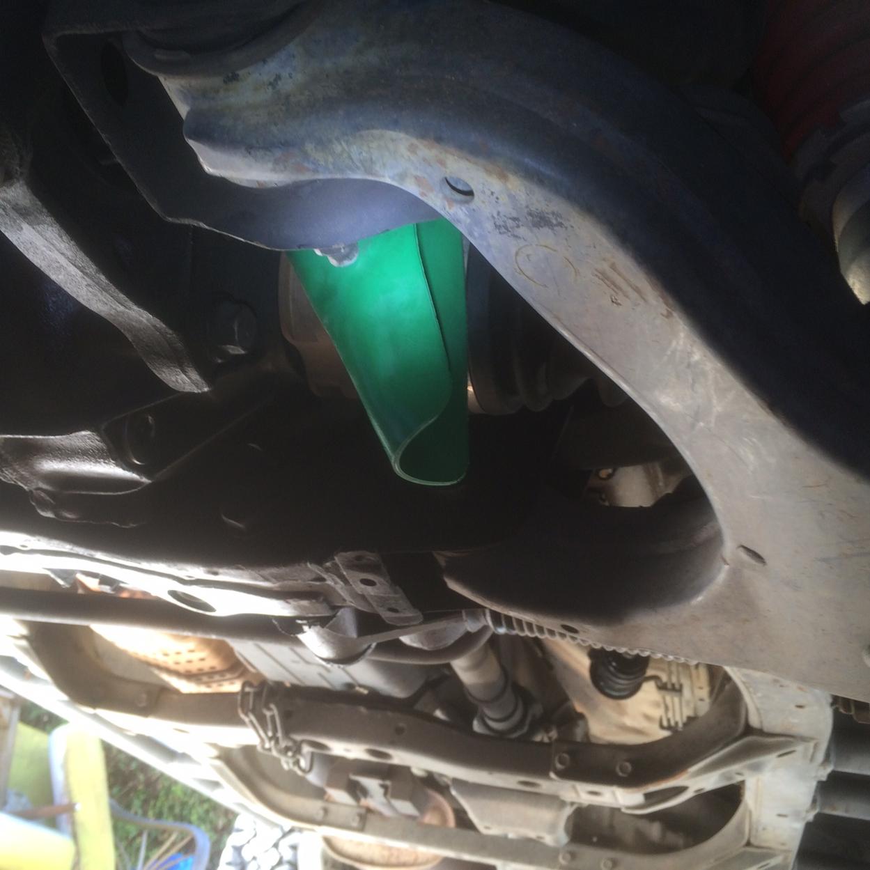

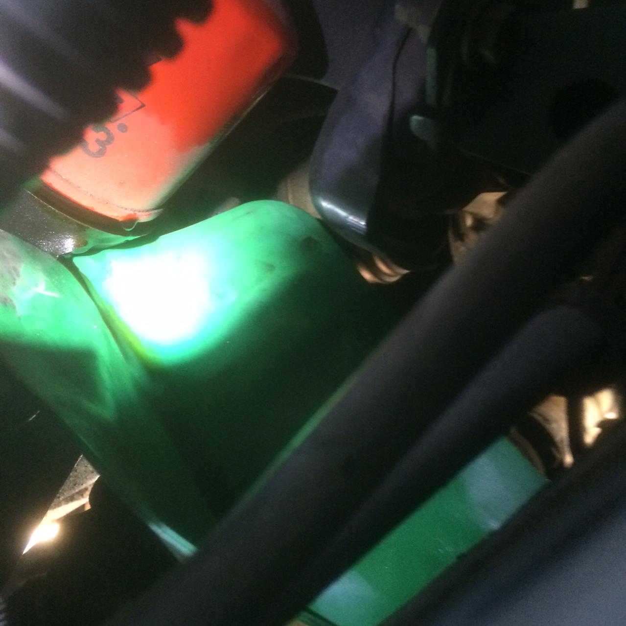

This is what I have been doing for 17 years. I don't sweat the oil. I just pulled the skid when I did the frame swap and I finally found something that will remove the crud. I went to paint it and the crud laughed at my big gas pressure washer. Then I hit it with the POR15 Degreaser since I was going to paint it with POR15, and it took that stuff right off. Good for another 17 years of letting the crud build up.
I keep the skid on and go through the wheel well for the filter. Should only take about 10-20 minutes. I just allow the oil from the filter to become rust-proofing for the chassis. If I want it to look neat, then I'll give the drain plug and filter a good spray with brake cleaner. The skid plate is a pain in the ass so I stopped goofing around with that a long time ago. I don't know if my mounts are stripped or if toytec sent the wrong bolts cause the rear bolts for the skid plate never want to engage properly.
