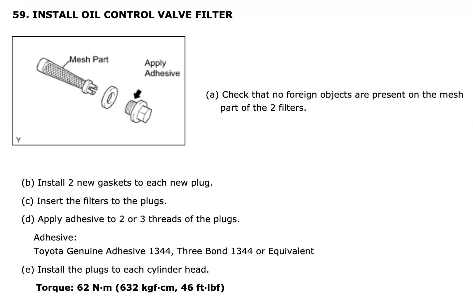

Get a new crush washer and torque the cap bolt to spec as shown in the attached service manual pic.

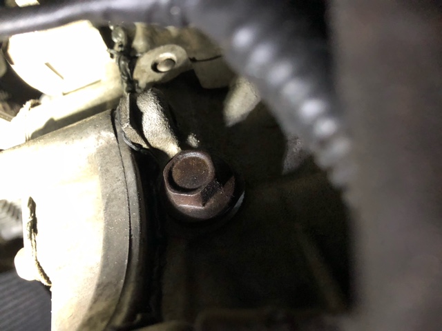

Got a picture you can post?
here you go, passenger side. when you take the bolt out the whole plastic filter comes out. its almost in exactly the same spot on the other side but i forgot exactly whats blocking access to it.

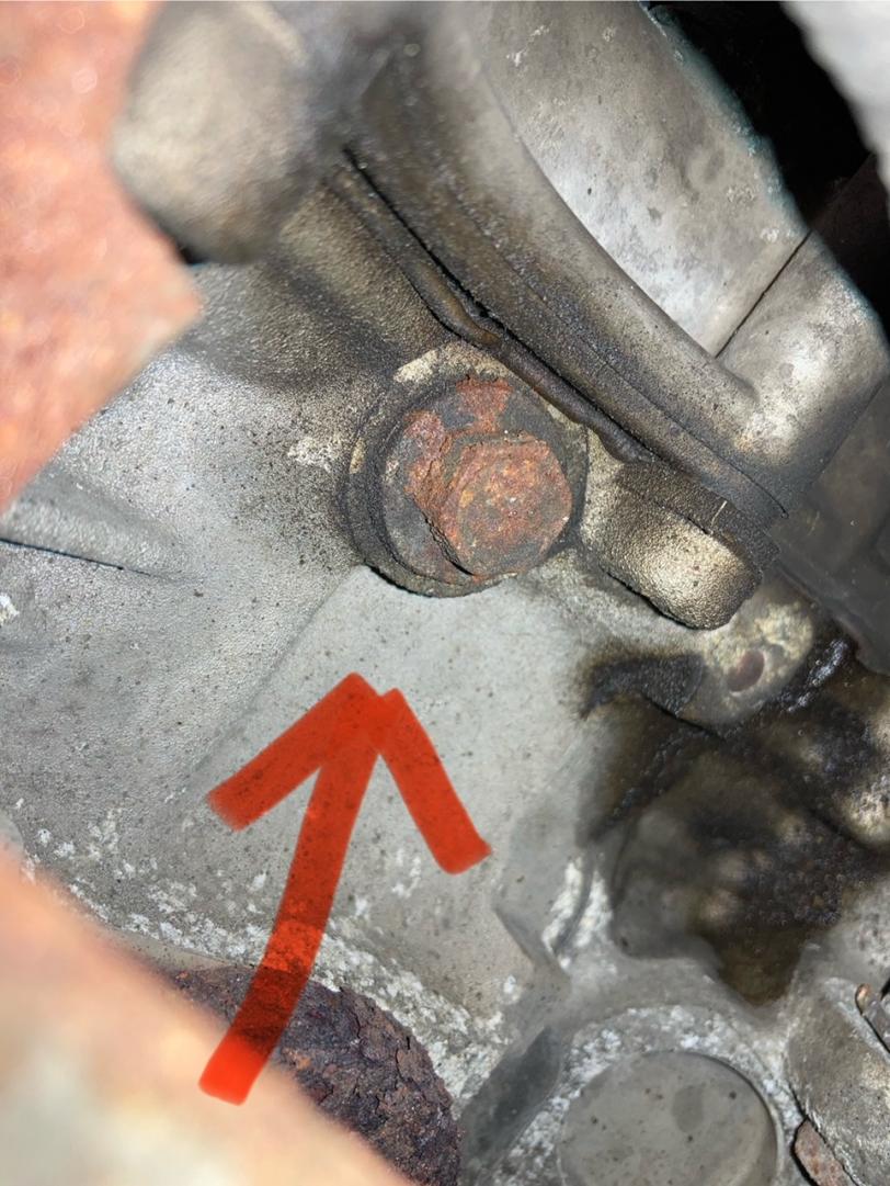

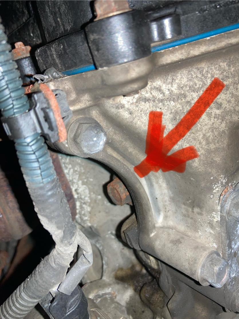

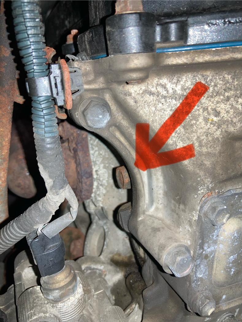

I found a rusty bolt head above the PS pump under the exhaust. Is this the filter bolt?
full

Looks easy enough but its not. Getting it back in was a pain in the butt. You have to install it blind and by feel. Dropped the plug twice down to the skid plate. But I confirmed the filter was clean as new. I use mobil1 so I expected that to be the case. Just turned 230k miles.
Hard to believe its 46 lbs/ft. I think that torque spec was for later engines with the banjo bolt. Just verified, That torque spec is correct.
