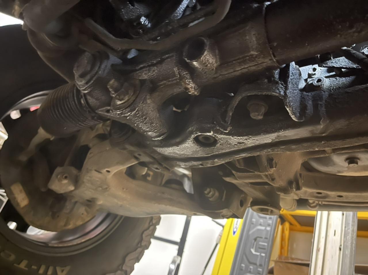

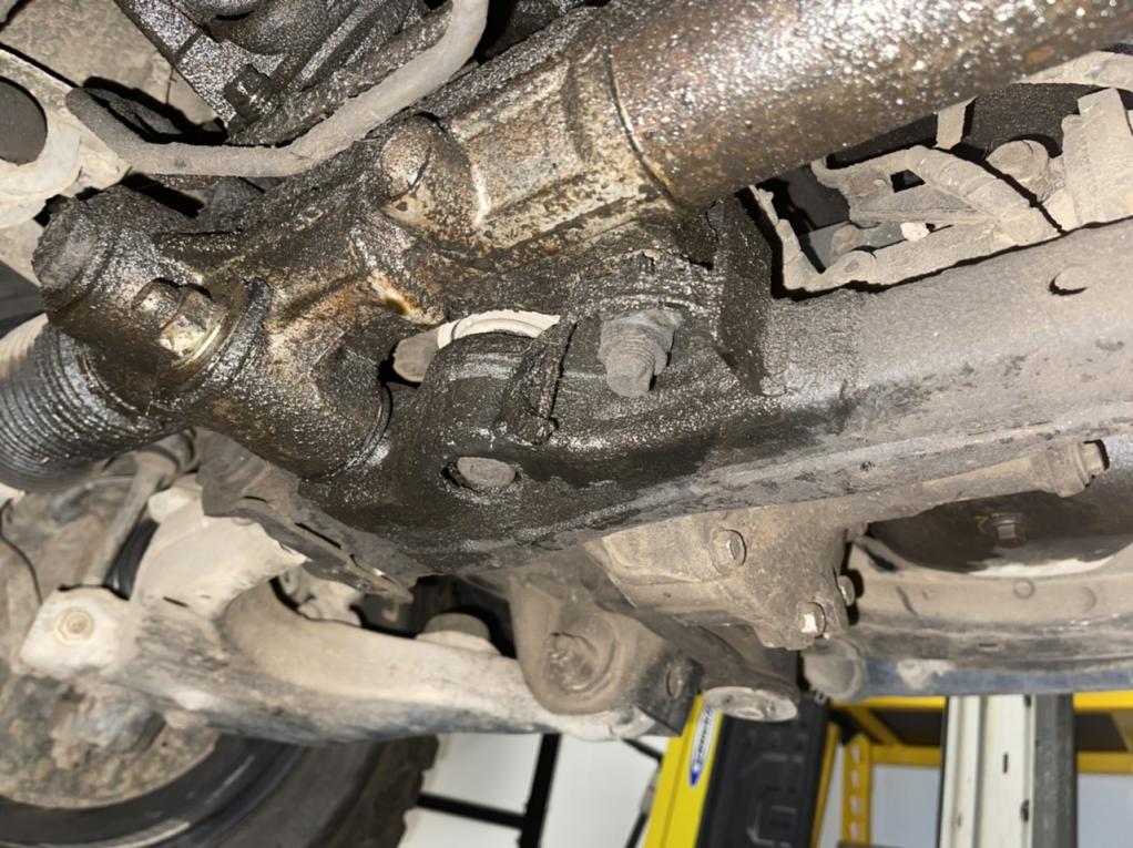

I took off the front skid (to access the starter.. another story) and notice oil everywhere. The dipstick shows full oil so don’t think it’s been leaking also there was no engine light. Where could this be from? Could it be front differential oil? Or just a loose screw or oil cap.

Pictures didn't post for some reason
If your front diff was leaking, you would only notice oil around the diff and possibly the CVs and steering rack. In no way could it "splatter" upwards and all over the engine

While the skid panels are off take it to a car wash that allows engine cleaning. Take a creeper and look at what you want to clean while your there. When you start pressure washing have eye protection. Things not to do is don't hit the alternator, exhaust system with a lot of water or the radiator everything else is pretty much fair game. I start from under the vehicle then move to the top. After you time stops let it drip a while and see what areas need more attention. After you clean it you can drive it then take a light and see where the leak is coming from.:pop2:
I'd get under it and see if you can track the leak. Look at the oil filter. It could be leaking from the filter manifold. There is an o ring that seals the manifold that sometimes goes bad.

There's a black light dye you can buy on Amazon for cheap and then get a simple black light flashlight. Put it in the oil, drive it around and check the engine bay periodically until you see it glow. The old oil won't glow since it didn't have the dye in it, only the fresh leak. Easiest way to find it with 100% certainty.
