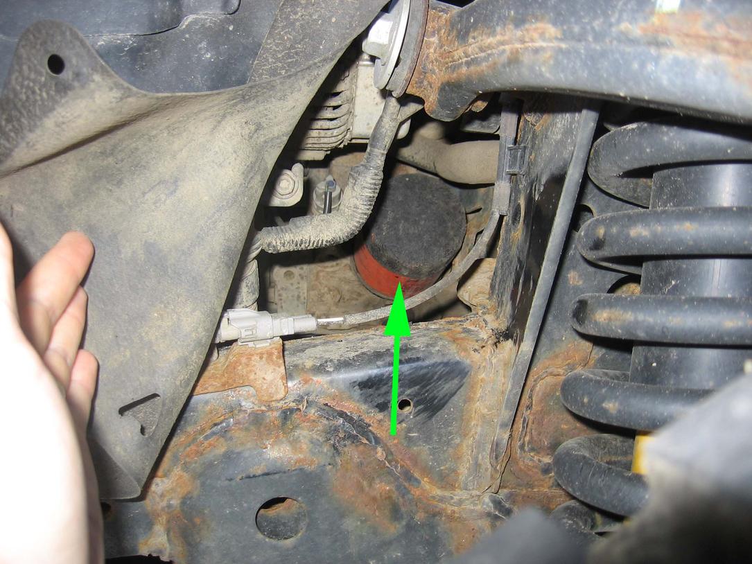

Just to clarify - that is NOT your oil filter. The oil filter is about 8 inches towards the front bumper from that thing. I don't even know what that is!
This is the oil filter. It's behind the wheel well flap that is in FRONT of the suspension, not the one behind. You were removing the wrong flap and the item you photographed is in fact the oil cooler. Do not remove that.
Yeah. I feel stupid, but I didn't realize there were two flaps until someone said that it was to the left of the picture I took about nine inches. Then I found the front flap, pulled it back and there she was. Okay, now that I know where it is, I can do the job. The skid plate doesn't cover the oil pan does it? I could get under there and look, but it's getting dark and I just took a shower.
