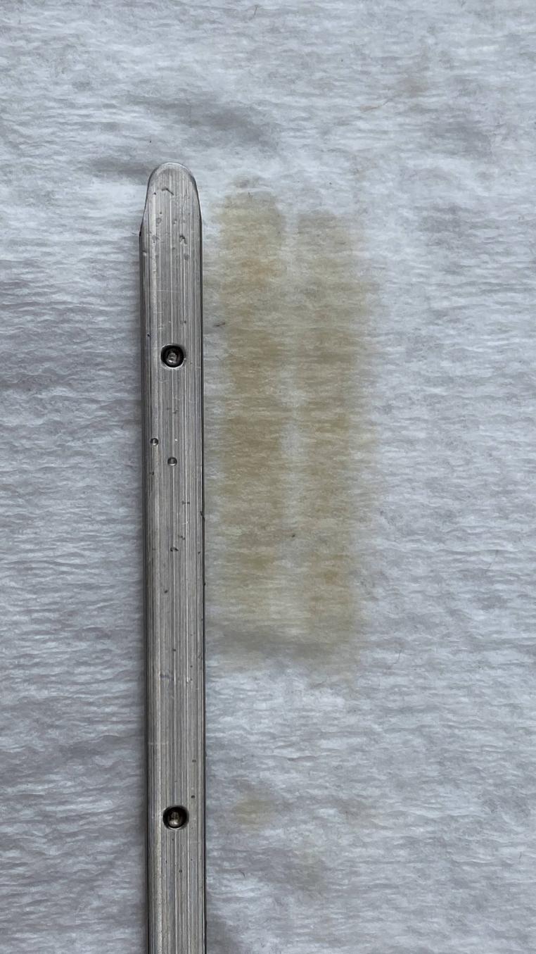

After letting the 4runner sit all night I checked the oil this morning and used the paper towel method to get a good read. I filled 6 quarts exactly and I see the oil level is a tad above the half mark. So I am going to stick with 6 quarts. Have one extra quart handy just in case.

TBH, I’ve seen no real difference in level between, warming and waiting for more than five minutes, and checking it cold the next morning. Maybe 1/16-1/8, I can’t even recall but definitely not 1/4 of the stick.
Once I’ve set the level after an oil change, the only reason I’m checking the oil is to make sure it’s in there and tracking oil loss, if any, there isn’t.
Toyota’s method simply does not work for many of us because the oil creeps up the stick.
Again, my suggestion to pull the stick and wait 5-10 minutes works for me and I recommend you try it if you’re having difficulty. YMMV

I put in 6 quarts and 11 or 12 ounces from the 7th quart and check the level when cold the next day and look at the back side of the dipstick. It's usually right on the dimple on the other side.
I use the remaining 20 ounces as a chaser for the next change for the T4 and my wife's car - half and half. Six years and 60K never needed to add any.
This ^^^. Need to look at both sides of the dipstick…. and trust the 6.5 and do’t fret over it.
