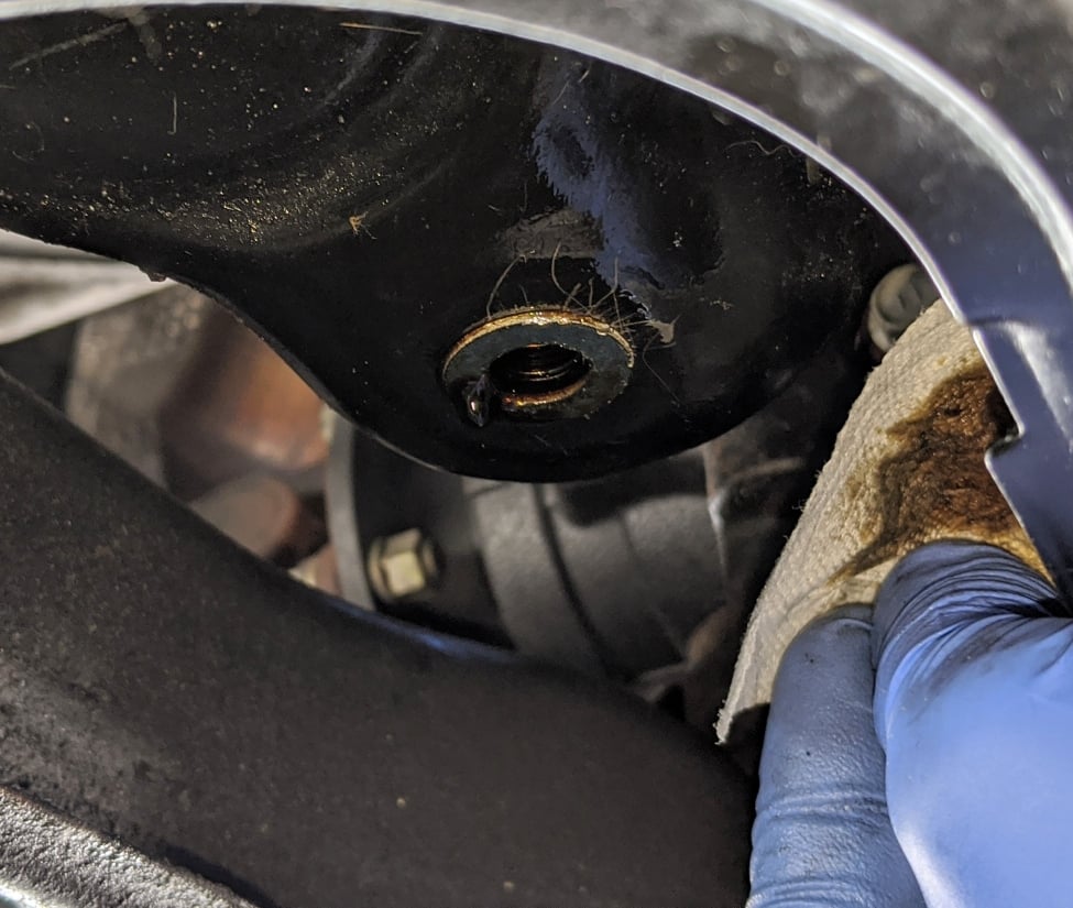

Hi everyone. Need some help. Purchased my 2009 Toyota 4Runner v6 March this year. Has 89,500. Decided to do my first oil change today. When I took off the oil pan bolt, I did not see a washer come off with it. But then I saw this, looks like a washer. I tried taking it off with a small flat head screwdriver as you can tell from the scratches. But it wouldn't budge. Didn't want to do any further damage... Possible that one wasn't put on, or..... Is that the washer just stuck hard to the pan. I ended up replacing the bolt w/new crush washer. Torqued it to 30lbs pressure. No leaks and runs great! Help?

Mine get stuck on every oil change, but as you mentioned, a little pressure to the lip with a screwdriver and they pop off.
I use a plastic putty knife to lift off these crush washers on my vehicles. $1 at the hardware store, no scratches on the metal.
