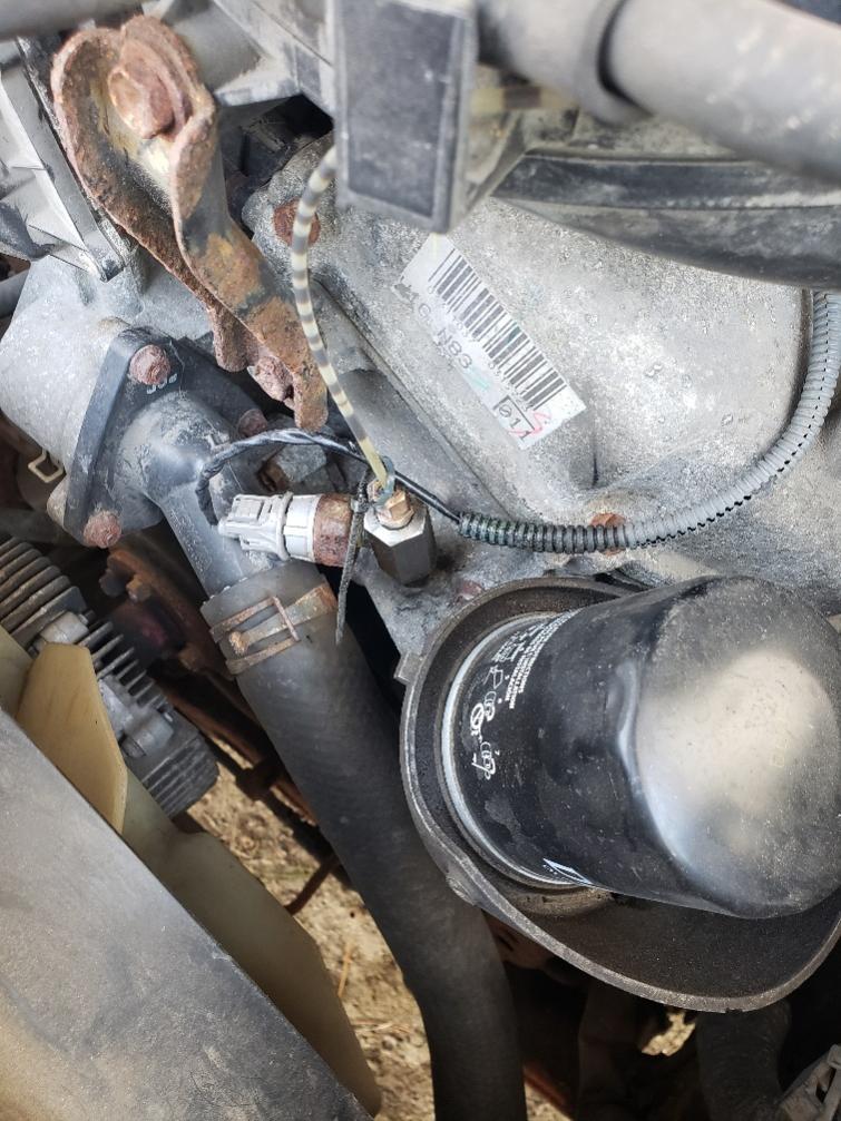

Sorry, I don't check this on the weekends. I have one on my 4th gen, just a standard cheapo one I needed as I was having oil pressure issues. Put a T on the sensor near the oil filter, it sticks up...can't miss it. I can take pics if you'd like.

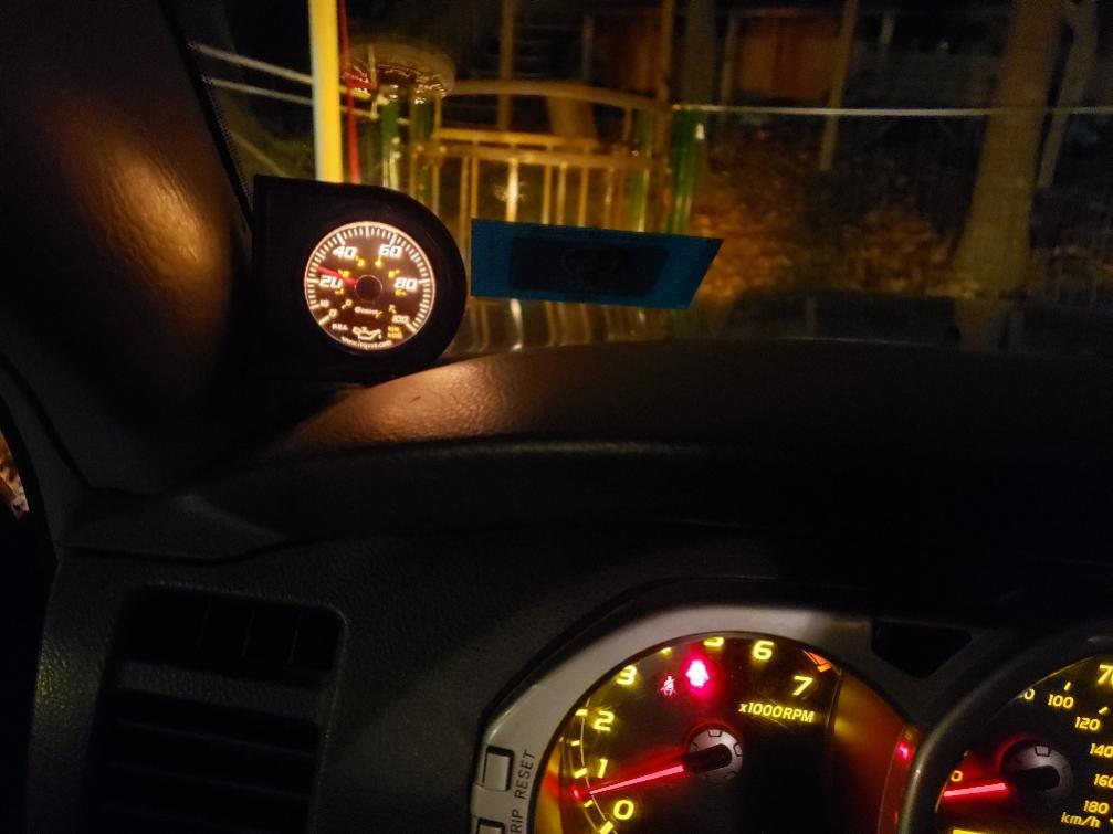

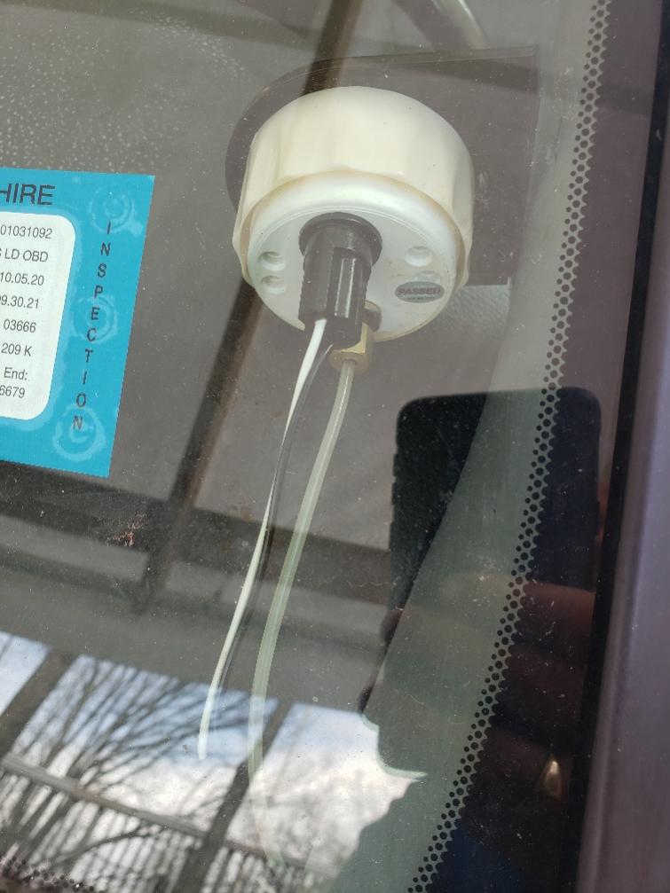

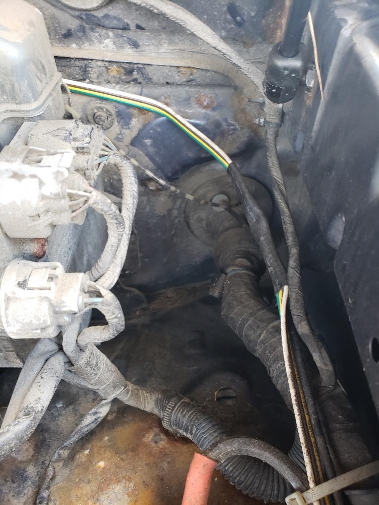

Braided hose is probably a good upgrade but this was supposed to be a temporary thing but now I like having it. The gauge actually matches quite well color wise. Pics below.

Did you drill and tap there or is there a plug?
I see what you did. Moved the factory to the rear of that tube and put the mechanical in the factory location.
Dear God, I hope that hose doesnt pop off and spray you in the face with 200* hot oil. :flame:

LOL, meh.... It's been on there for over 2 years and I watch it and the gauge. The tubing is actually pretty thick but a metal or braided hose would be better. I needed the gauge because of a flickering oil light issue that was a real oil pressure problem. The pressure would start off fine then drop off after warming up. Ended up being a sludging issue I assume because the former owner didn't like maintenance, I picked it up pretty cheap. Cleaned all the sludge from the top end and the plastic like hardened oil from the pickup tube which helped some. The real fix was running motor flush as directed on bottle. It seems the pressure relief valve in the pump was sticking open. Been good since then and my daily driver for 2+ years.
