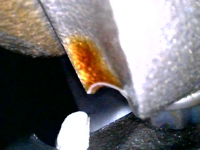

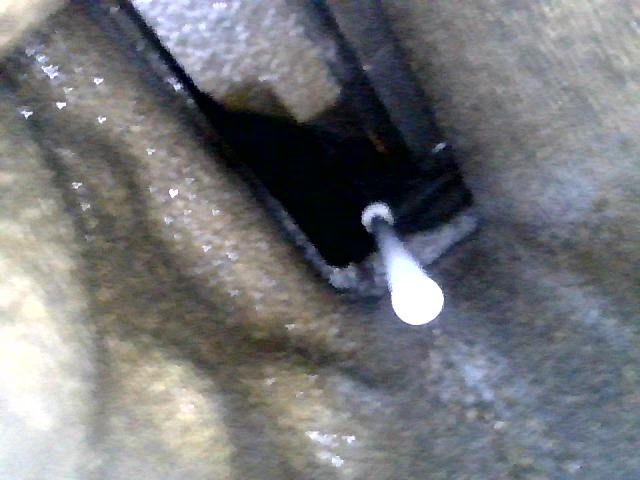

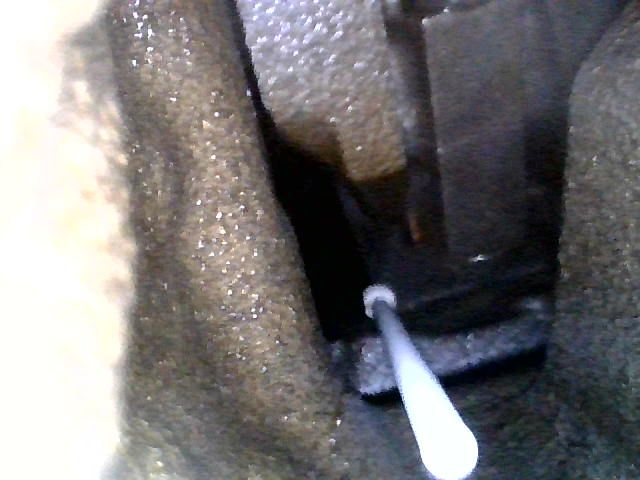

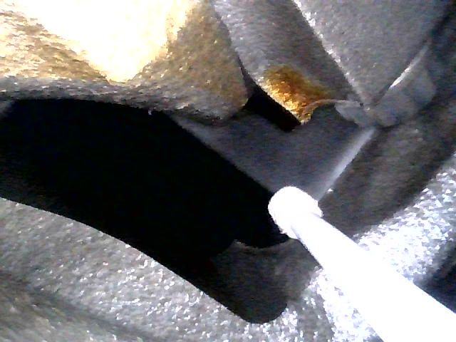

I took the following pictures with the endoscope:
It looks like the q-tip is precariously perched on the edge of the splash shield; does that look right to you?
This leaves some difficult choices:
1) Do I try to take a vacuum with some semi-rigid tubing and hope that I can make the one-in-a-million blind snatch of the q-tip shaft, risking knocking the q-tip into the pan or onto the splash shield?
2) Do I take the cylinder head off and get it from the top, while praying that I don't bump it off the splash shield into the pan during disassembly (or f-up something else)?
3) Do I use the endoscope and push it off the splash shield into the pan and attempt recovery from the pan drain?
What I don't want to do is remove the oil pan, I watched some youtube videos on the process and it looks like it super-sucks.
You won’t be able to see with a vac hose.
I think your only choice is to knock it into the pan. And then hope it floats to the deep part when you drain it.
Once in the pan as long as you can keep it off the splash shield you should be able to put the camera up the drain hole and find it and drag it over to the drain hole.
If it got stuck on the splash shield I think I’d just jack up the back of the rig to slope the engine forward and then dump oil down the head drain holes and try to wash it to the sump of the pan.
You might try that rather than dragging it with the camera.
You should be able to wash it into the bottom of the sump at the front of the pan and then use a hook or needle nose to pull it out the drain hole.
Thanks for your reply, I have enough posts now that I started a dedicated thread. I'm thinking sending it into the pan might be the easiest option. Of course I'm only guessing that it is sitting on the splash shield, I'm hoping someone can confirm that for me. Please reply on my new thread if you can offer additional help.
